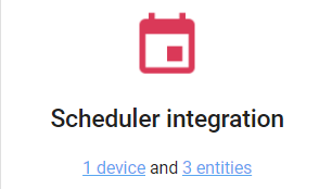

  • In the integration it is possible to add several schedulers, it is voluntary (1 scheduler per thermostat for example…) or just something to correct ?

I have an integration of the scheduler, but it is possible to add more…
Most people just use the same one, and instead just use filters on each card.
@Canaletto The integration is just there for storage and timekeeping. The ‘1 device’ is also a fictive device, simply because in HA it is required to have one. There is not really an added value to splitting it up. I would like to keep it centralized.
