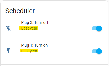

I upgraded HA to 2023.1, and upgraded the Scheduler and Scheduler Card this week. Something has been broken in one of the components.
The scheduler card show the events as “Last Year”:
If I set a Period on the Options tab, then it will show correctly:
It will count down correctly, but the action does not complete.
I have tried removing and reinstalling the components, no difference.
Ideas?
This ended being a system time problem, had to static the network and set DNS to Google (8.8.8.8), then all was good.
