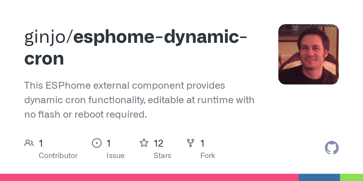

There’s also external component (I haven’t used it) which looks well documented and recently updated.
