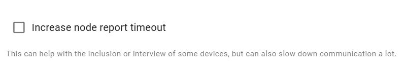

The lock did not interview completely due to the extend time period needed for lock interviews. If you are using ZwaveJS UI then you can change the interview process length by temporarily enabling the following feature:
Once the lock successfully interviews then disable the above feature.
Changing timeout didn’t help
