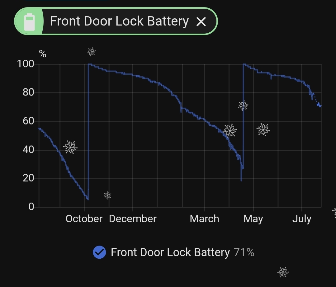

Anyone else seeing poor battery life with the Encode locks? I installed some about a 18 months ago and they seemed to get around 6 months of battery life. Lately they seem to be getting considerably less. Makes me wonder if HA polling is involved. As in, waking up the locks too often and draining battery life.
Wow, 6 months! How’d you acheive that? I get almost exactly 90 days. I’d think that the physical opening/closing the lock would be way more of a drain than HA could put on it. Also, since you can always access this remotely from the app (not HA) does it ever really sleep?
In my experience, low WiFi signal is the worst culprit. Buy a cheap repeater and place it near the door.

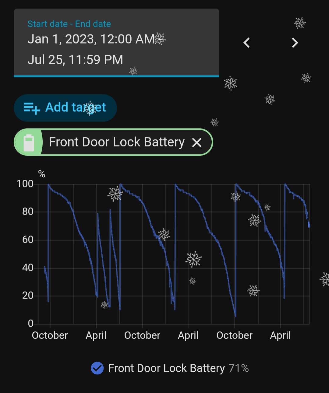

I’ve got about 3 years of data, have changed the batteries about 5 times, getting about 9 months of battery life.
Wifi AP is about 4 meters from the lock so good signal, bolt barely drags a seperate/main door handle latch pulls the door closed tight to allow this.
