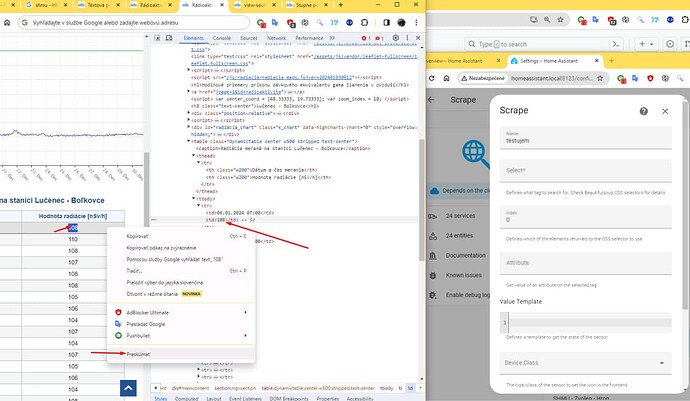

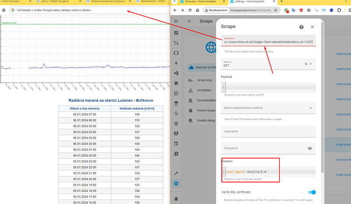

#maincontent > section > table > tbody > tr:nth-child(1) > td:nth-child(2)
can sombody help me solvethis problem ?
