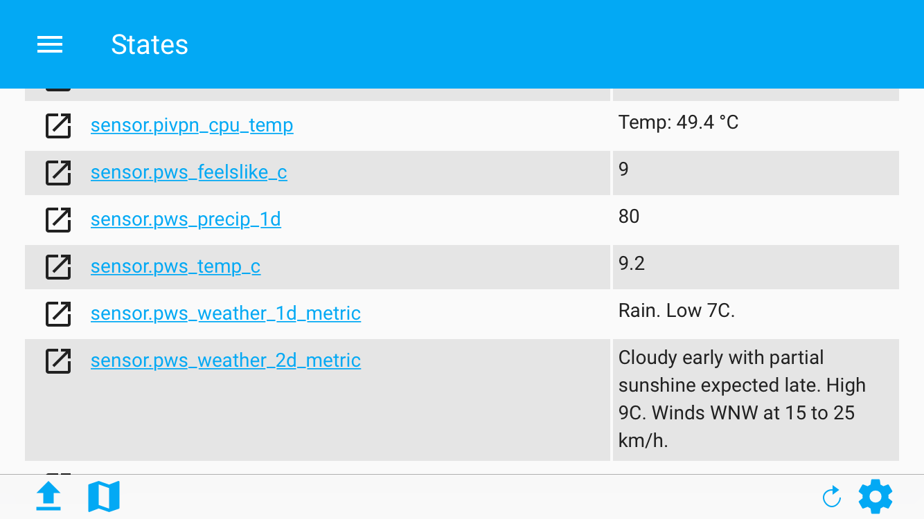

If you click on the sensor in dev tools what does the JSON look like? (in the states) Does the Temp: 50.5 °C show as the state?
Yep, it’s showing the full text as “Temp: 50.5 °C”
But is it showing that as a state???
I think so, it’s in the states box, where you would expect to find on/off for switches etc.
