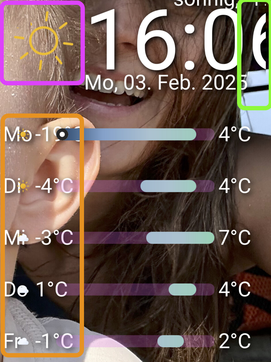

I’m new to Home Assistant and experimenting with creating a custom screensaver using the clock-weather-card. I’ve been making some progress, but I’m running into a few issues and would really appreciate your help!
My Issues:
  1. Enlarging the Weather Icon (pink circled):
    The weather icon (e.g., cloudy, sunny, etc.) looks too small compared to the rest of the card. I’d like to make it more prominent. When I try increasing the size using card_mod, either nothing changes or the icon appears cut off.
  2. Adjusting Forecast Layout (orange circled):
    The forecast rows (day, temperature, etc.) are now well aligned and nothing is cut off, but the entire layout feels too small overall. I’d like to ā€œscale upā€ the whole section to better fit the screensaver.
  3. Scaling the Entire Card:
    Although I’ve managed to resolve some layout issues, the card still feels too small when viewed on my screen. I’ve tried using the zoom property in card_mod, but the results don’t quite give the larger, readable look I’m aiming for.
My Current YAML:
Below is the code I’m using. I’ve worked on it with the help of ChatGPT, which has been super helpful for me as a newbie! However, I can’t quite figure out how to achieve the scaling and alignment adjustments I need:

Challenges:
  • The weather icon size doesn’t change as expected or gets cut off.
  • The forecast rows are aligned, but the whole section (and the card overall) feels too small.
  • Scaling the entire card properly for better readability on the screensaver is proving tricky.
I’ve attached a screenshot to better illustrate the issues I’m facing. If anyone could help me:
  1. Enlarge the weather icon without cutting it off.
  2. Scale up the entire card for better readability.
  3. Fine-tune the layout for a polished screensaver look.
Your advice and guidance would mean so much to me as I continue learning Home Assistant! Thank you in advance for your support! :blush:
