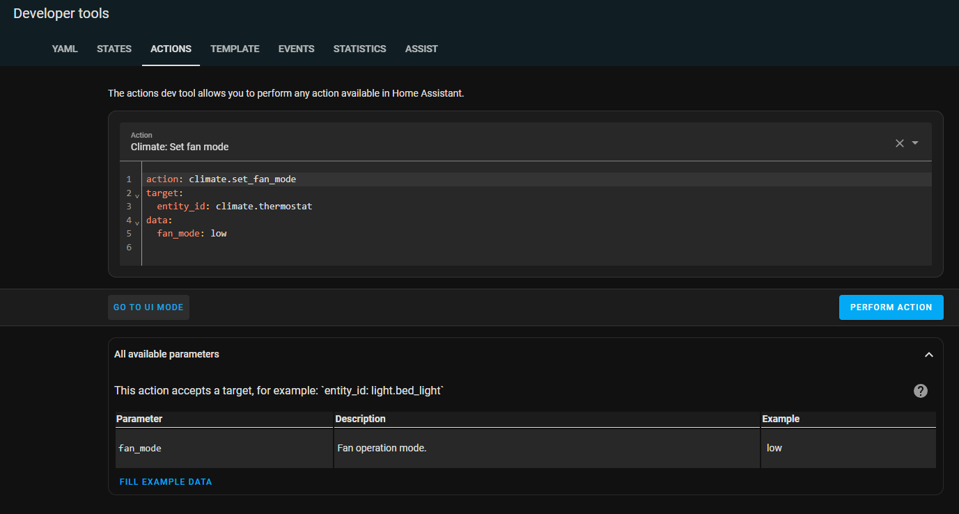

Develper tool is your friend
then
fix it in yaml mode
then you can paste it in your script this is the way i do ti
The editor in developer tools is a subset of the automation/script editor. The developer tools just uses the action part for one single action, but it cant do building blocks, compound statements, conditions or triggers.
There’s nothing wrong with manual coding if you know what goes where. I do it a lot too. The automation editor can teach you the structure when in doubt. Just switch to raw mode afterward and see what it produced.
