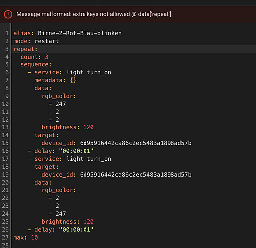

Hi all,
I just tried a little script which just should switch a light to red, wait 1 sec and switch it to blue, wait a sec and repeat this a certain amount of times.
But I get the following error:
What am I doing wrong ?

Please don’t post pictures of text. Post the actual text and format it correctly for the forum. https://community.home-assistant.io/t/how-to-help-us-help-you-or-how-to-ask-a-good-question/114371#oneone-format-it-properly-16
That way we can help you a lot easier with cut/paste/edit.
You have created a script that’s missing a sequence
statement.
Add sequence:
after the line containing mode:
then indent all remaining lines as shown below, except the last line containing max:
alias: Birne-2-Rot-Blau-blinken
mode: restart
sequence:
- repeat:
count: 3
sequence:
- service: light.turn_on
... etc ...
max: 10
I agree with tom_l, in the future please post your YAML code as text not as an image. I only entered the first few lines of your example because I’m unwilling to re-type everything from the image you posted.
Thank you for the correction and sorry for the picture !
Next time you get text.
