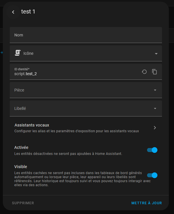

I create a script in UI and rename it in UI (title and entity_id).
When i do that, action can’t find the new entity_id, renaming is not really working.
Then i look in yaml and find the old entity_id, the rename in IU didn’t change it.

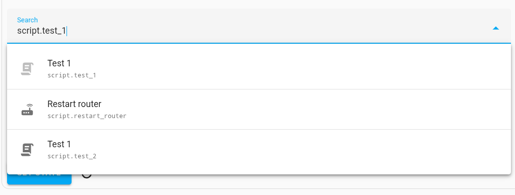

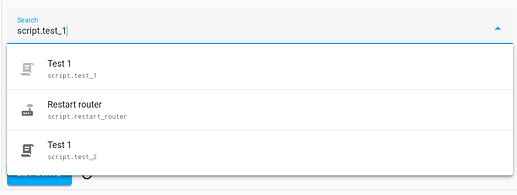

I notice that after changing the entity ID of a script in the file editor, the old name still appears in Developer Tools | States, which shows it as “unavailable”. This remains after a restart and even after a reboot. Even if you delete the script with the changed entity ID, the original is still there.
Maybe part of the problem is that we’re thinking of changing the entity ID of a script as “renaming” it, whereas it’s more like cloning.

Again… next few words of you quote. More info. The button that is an (i), then you press the cog wheel as usual.
I thinknunderstand what op is saying. It’s not a bug. They’re renaming the script in the rename script block (or in the alias in yaml) expecting it to update the entity_id.
Op it does not. You must edit the entity ID in the more info dialog (the gear icon) to get this.

This will update the entity_id but not the service. I.e. if you use script.turn_on with your new entity_id, it will work.
This is a known limitation. Likely will get rejected if you file it as a bug.
I.e. if you name something script.test_1, the service/action will be script.test_1 and the entity_id will be script.test_1. If you rename the script entity_id to script.test_2 via the UI, the service will be script.test_1 and the entity_id will be script.test_2.
Meaning, this will be same regardless how many times you change the entity_id:
action: script.test_1
but this will need to be updated after you rename the entity_id
action: script.turn_on
  entity_id: script.test_2
