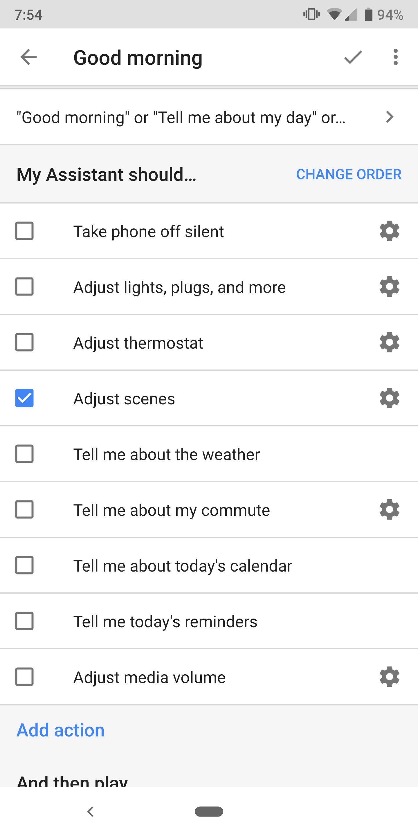

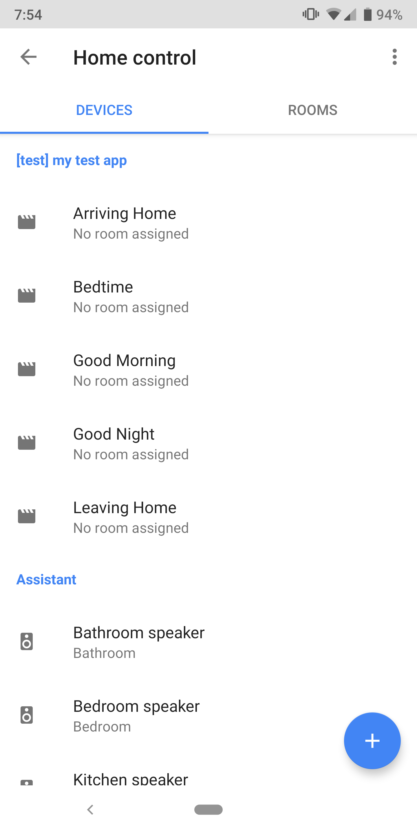

@hiscorebob So I believe I figured it out. If you add the script as a scene change (a default option) it doesn’t say anything. So instead of adding an extra action for turn on x just do it as a scense. Seems to work perfect. Hope this helps!
@codymhorton Thanks for the info, but I’m not sure that I got you right. Could you please be more specific on how to add a script as a scene change?
@hiscorebob sure thing I’ll attach some screenshots. So when you add scripts via HA to the Google Assistant they show up as scenes (little video icon). You can select to use a scene in any routine and Google doesn’t say turning on the… anymore.
Ha, I learned something new. Thanks for sharing this!

Scripts don’t show up on the front end of the Google Home app. If you want to see them go to Google Home APP > Account icon(on the bottom) > Settings > Assistant(tab) > Home Control

Scripts show up as Scenes in Google Assistant’s Routines.
