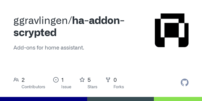

Wanted to learn a bit more about ingress and how to create add-ons so I scribbled together an add-on for Scrypted with ingress support:
Edit: some people are experiencing issues with getting this to work (see below). Unfortunately, I don’t have time to figure out why. The project on Github can be opened in VS code if you wan’t to play with it and try to find the reason of the endless loop.
