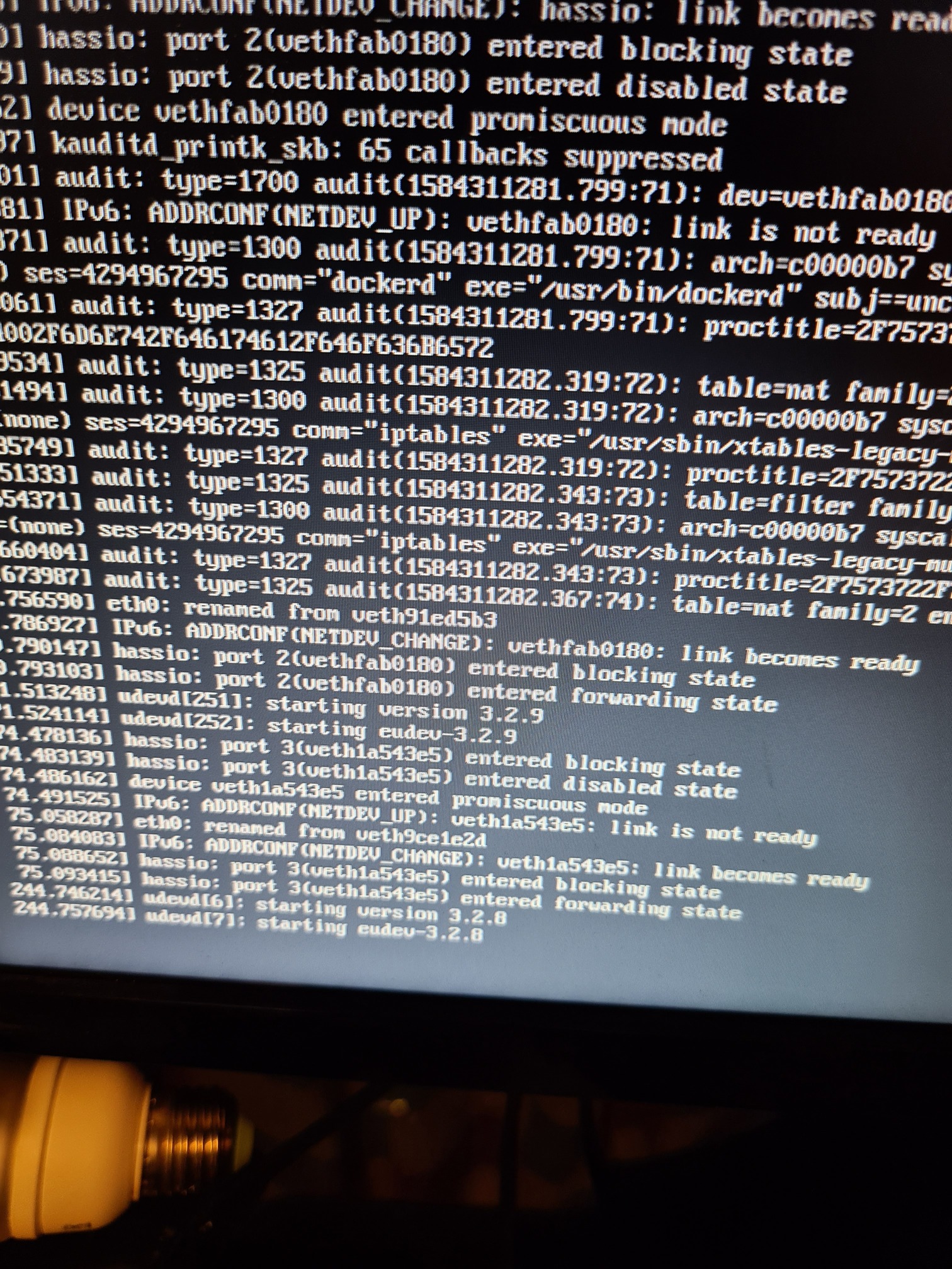

OK I should have Raspbian and home assistant on the same sd card now. However, tutorials I have seen suggest that the raspberry should reboot at the end of installation. I seem to be stuck on the installation screen. The web page and Home Assistant app on my android are connecting fine. However, I was expecting Raspbian to open on my Pi.
OP mentioned noobs so it sounds like he used noobs to add raspbian then I guess etched HassOS and wiped raspbian with the HassOS but it’s all a bit confusing as not a lot of detail on what was exactly done.

I 100% agree with you, just load the pi4 (I think that’s what he’s got and I can’t be bothered to scroll up) hassos image and write that.
I think he doesn’t know what headless is.
