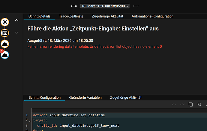

I checked the trace, and the error is within that block, but I don´t know what it means:
action: input_datetime.set_datetime
  entity_id: input_datetime.golf_tuev_next
  date: '{{agenda[''calendar.vorname_nachname_de''][''events''][0].start }}'
That’s not the same error that you’ve been saying in the previous posts. That is saying that the events list is empty. Meaning that agenda is populated with a response, but the response didn’t return any events.
Are you sure you have events in your calendar that the calendar is providing to HA? Are you sure you have the correct calendar entity_id?
