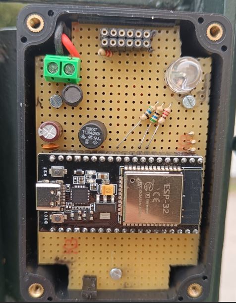

Fingerprint-Controlled Relay Hardware Example
This update shows how to build a simple fingerprint-controlled relay device that integrates with Home Assistant. It can be used to control doors, appliances, or other automated systems.
More info, including wiring diagrams and firmware setup, is available below:
:link: hardware & schematics

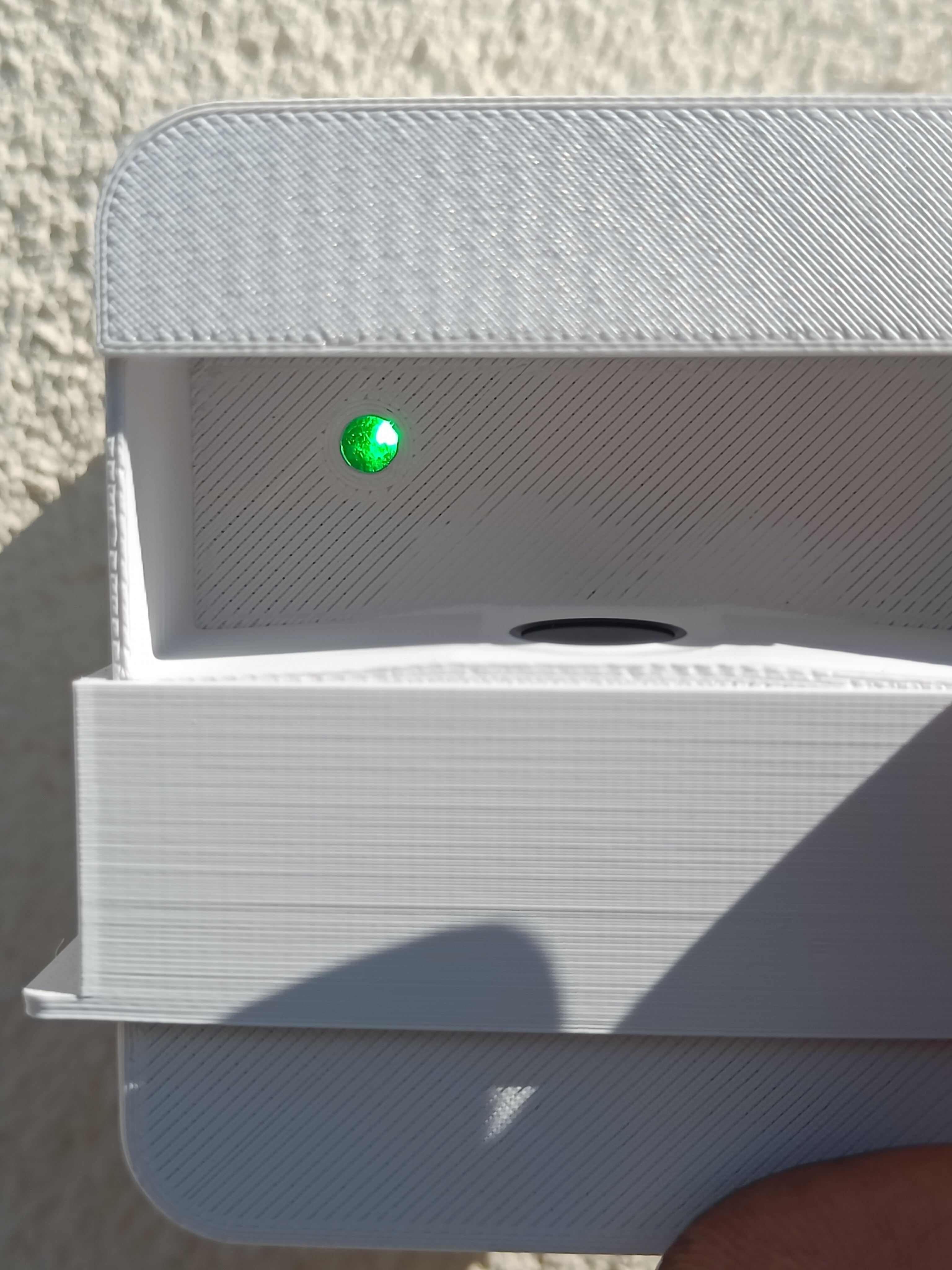

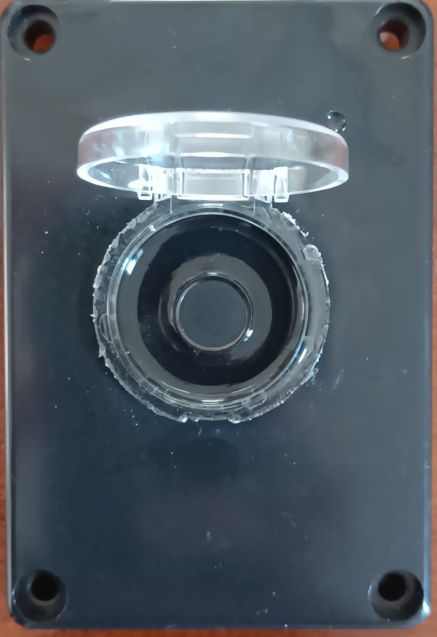

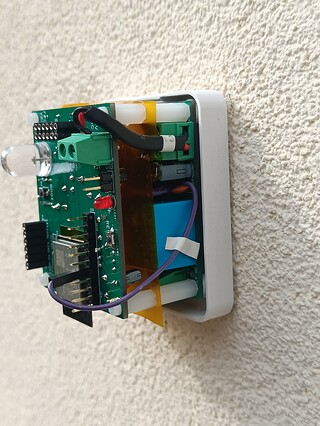

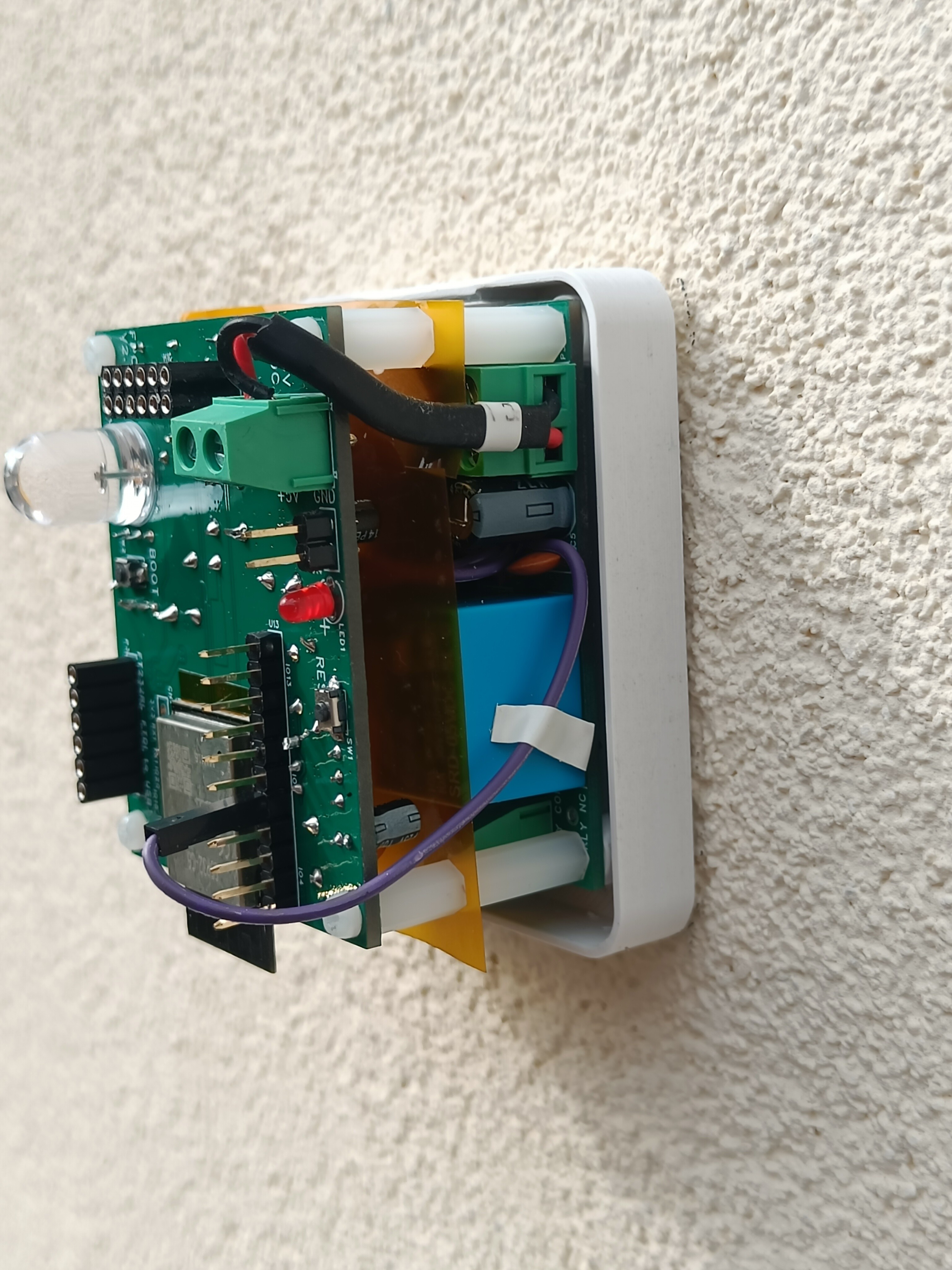

:rocket: New hardware release: ESP32-C6 + FPC2532 fingerprint module
I’ve just pushed a new version of the project with a complete hardware stack for a fingerprint-based relay device.
:point_right: What’s new:
  • :electric_plug: Full power supply PCBs (AC/DC + DC/DC + protections)
  • :repeat: Dedicated relay board
  • :brain: New ESP32-C6 support
    • including Thread communication

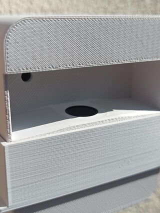

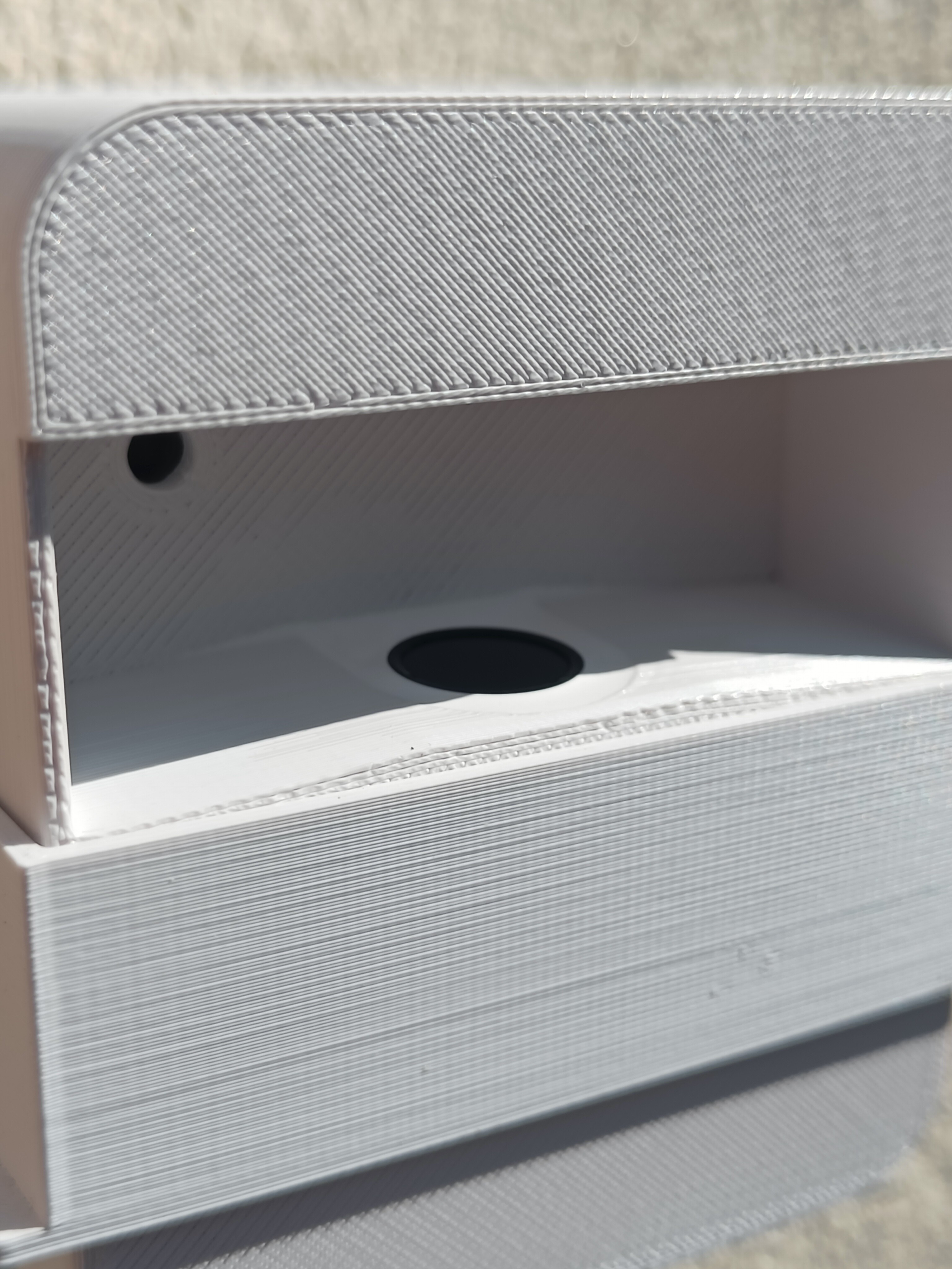

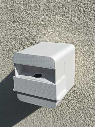

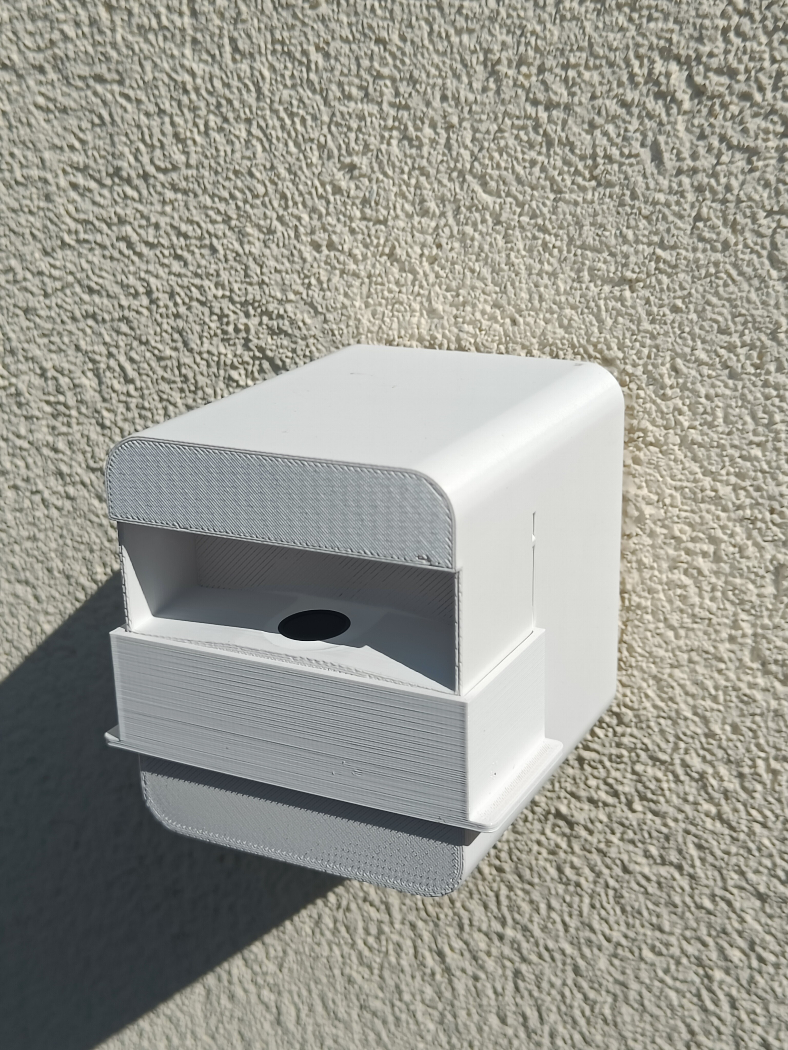

  • :brick: 3D printable enclosure (outdoor-ready, IP-sealable)
The goal is a compact, reliable and secure fingerprint controller you can actually deploy (door, garage, access control, etc.).
:camera_flash: Hardware & Assembly
This builds on the original idea of a more secure alternative to typical ESPHome fingerprint sensors (encrypted storage, no image extraction, lower power)
More details (schematics, case, wiring, etc.) in the repo :point_down:
:point_right: hardware & schematics section
