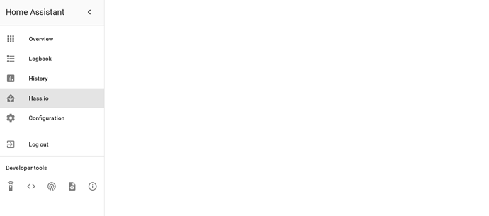

Tor add-on for Hass.io
Franck Nijhof (@frenck) created the Tor add-on for Hass.io. This add-on makes the installation and the setup extremely simple. Go to the Hass.io panel, then to the Store, copy https://github.com/hassio-addons/repository into the text box of Add-On Repositories and save it.
A new entry Tor will show-up in the list of add-ons. Click on it to install it. The configuration is done in Options. Please refer to the Configuration documentation for further details. A possible configuration could look like the sample below (which is the default configuration).
