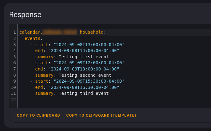

The calendar dashboard can show all the events in a google calendar but we can’t interact with them as entities, only the next(current) one is an entity.

There was a way to separate calendar entries into separate “virtual” calendars/entities.
However, since the Google integration into core HA, I’m note sure if that’s possible with the core setup.
I’d set mine up in the old way and it still continues to work with separate calendar entities.
But, yes, it would be great if they could work this way natively too.
This was the reference that I followed to set it up.

Fixed in a patch release
Yup, but the WTH request would be a great addition
