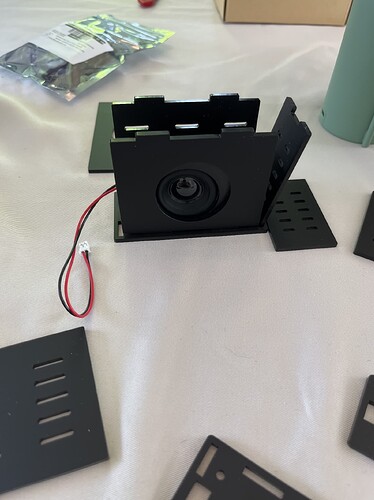

Upon opening the package, I was disappointed to find that there was no user manual or instructions included. You’re left to figure out how to mount the module on your own, and basic components like screws for mounting the speaker are not even provided.
So here is how it looks :
I stopped trying mounting it for now, as I don’t even see how to screw the speaker properly in this printed case…

Bro, scan QR code on the packaging. There’s PDF with assembly instructions. I assembled two devices without any trouble. Then I flashed i2s software to the XMOS, ESPHome to the ESP board - and have perfectly working device. Single disappointment I have now is the fact that hardware mute doesn’t have current state published (no on/off, just toggle).
P.S. Speaker isn’t screwed down, use sticky pads (flatter ones).
