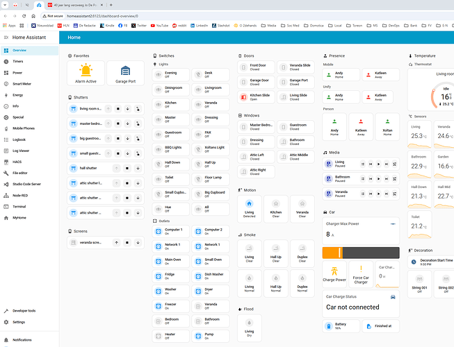

I created a dashboard to see just about everything I want to see in my home.
When I go to the HA dashboard I see this
Everything fits and it shows nice icons

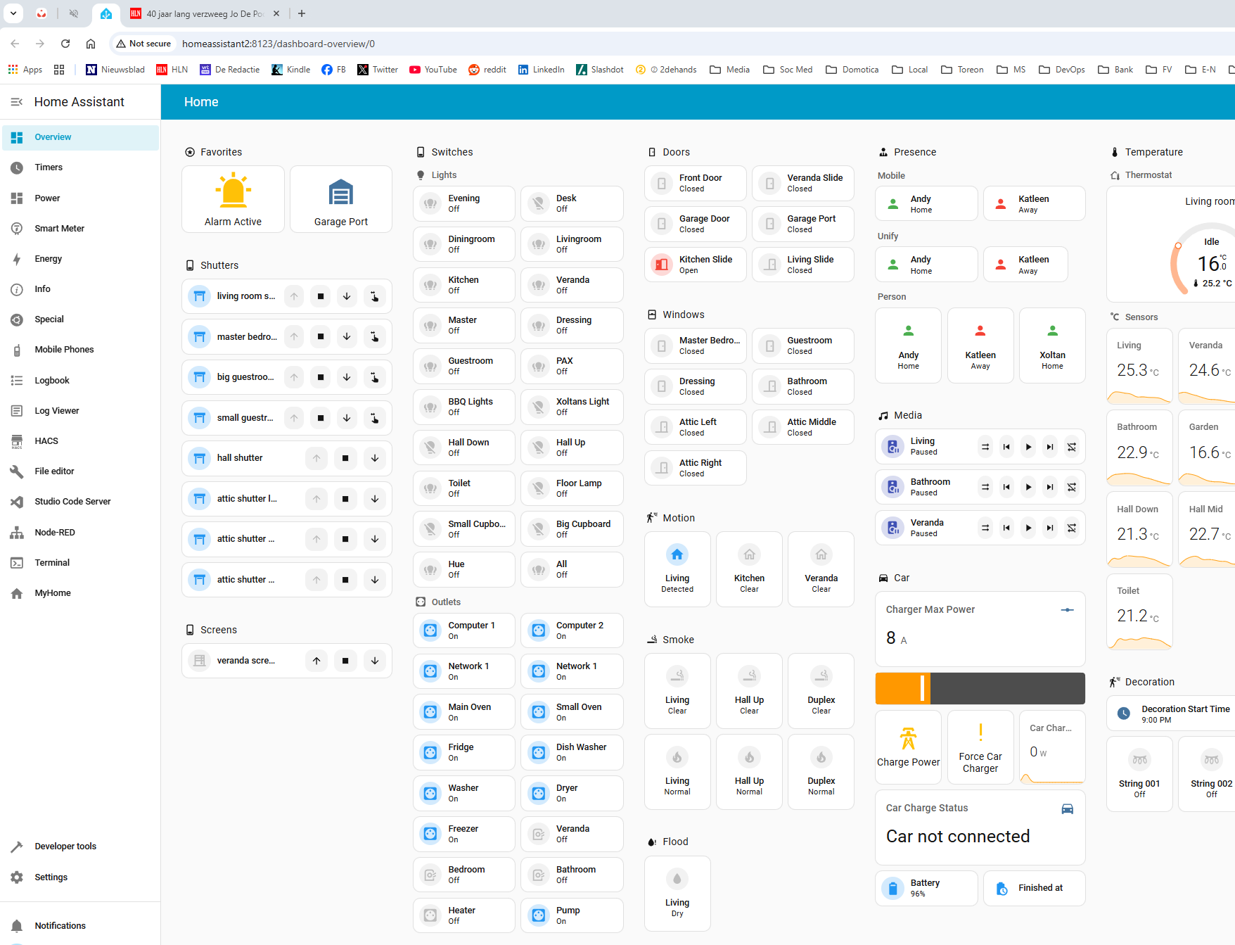

But when I refresh I see this:
not everything fits and far less icons
any idea why this happens???
If I reload the page I still see the bad version, but when I hard reload the pay I get the good version…

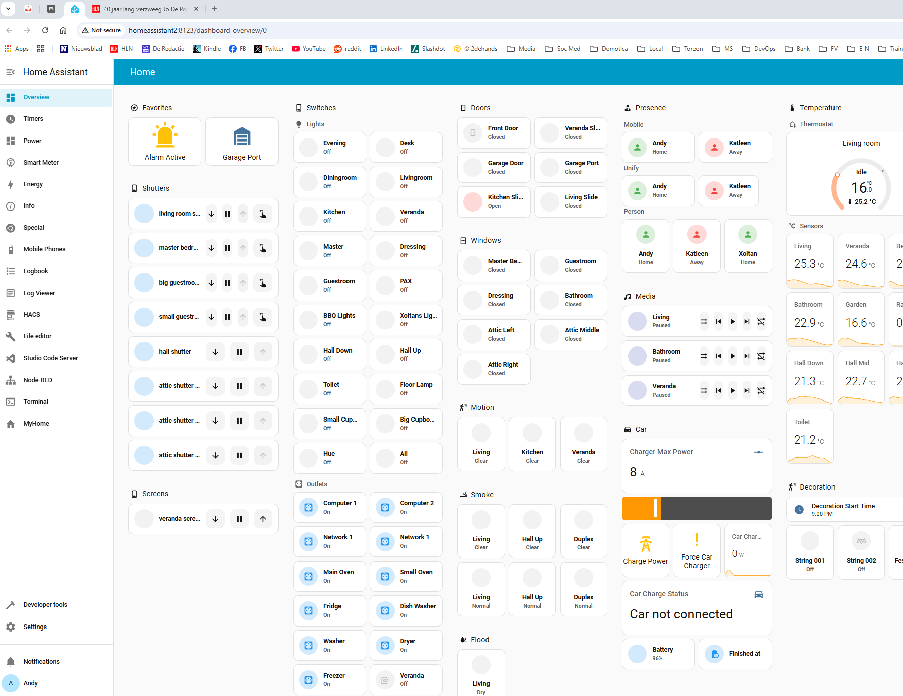

3
In incognite mode I can refresh multiple times and I always get the nice version, the version I want.
So yea, may be related to front end cache.
But what do I then need to do to always get the correct version without each time having to clear the cache or doinig a hard refresh?

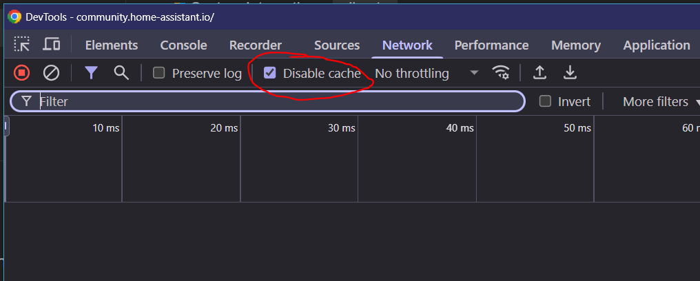

Open developer tools for your browser (usually F12).
Go to the network tab & select disable cache option in top left. Will edit this post with a screenshot as soon as I’m back on my PC.
Edit: Here you go

Wil this be for this site only or is that a generic setting for all sites?
kryptonneke
(Andy Meyfroidt)
6
Hmmz strangely enought, the cache was already disabled. I now re-enabled it and I’m so far always getting the correct site.
It’ll be for all sites. Glad you managed to fix your issue by enabling it though.
