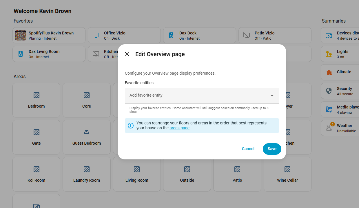

Mind you, this is very much like the new “default” dashboard. Except I find the layout impossible to replicate.

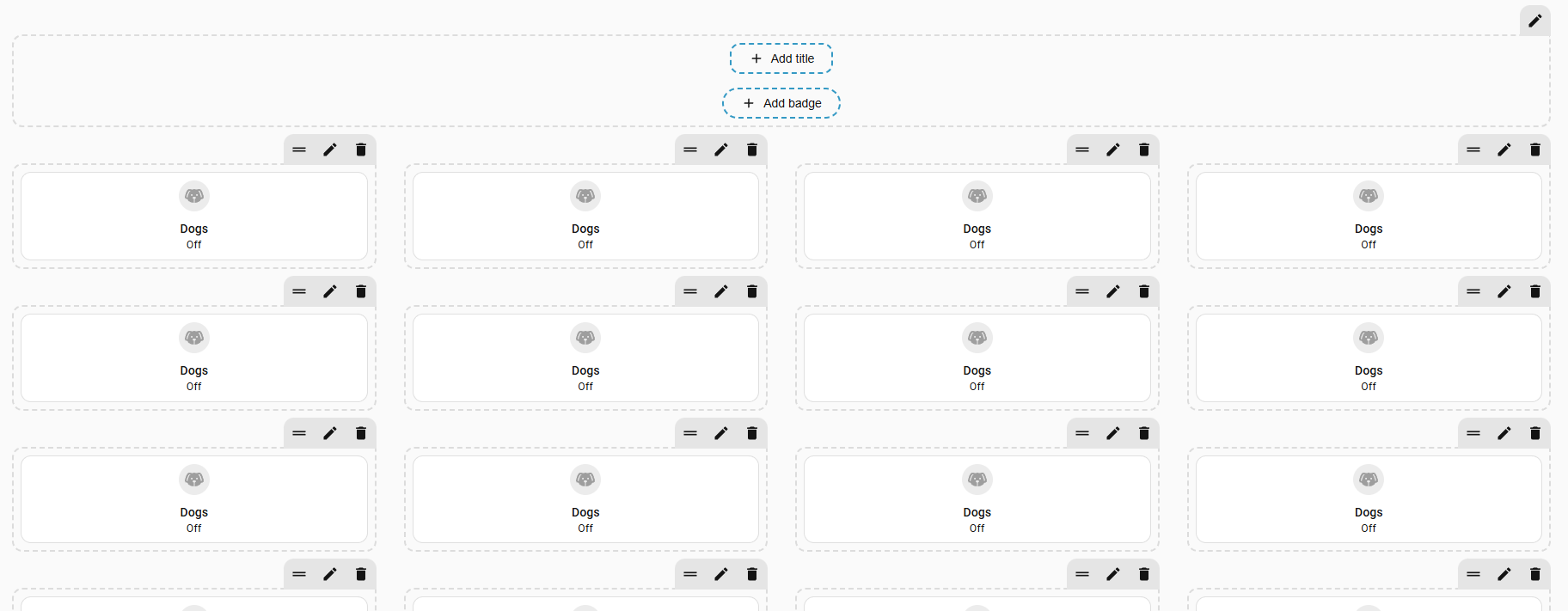

Example (trying to cut it back):
How do I get 8 columns across in the grid?
decluttering_templates:
  shroom_group:
    card:
      type: tile
      entity: '[[group]]'
      tap_action:
        action: toggle
      hold_action:
        action: none
      double_tap_action:
        action: none
      state_content:
        - state
        - brightness
      vertical: true
      features_position: bottom
views:
  - title: Rio Crest
    type: sections
    max_columns: 8
    sections:
      - type: custom:decluttering-card
        template: shroom_group
        variables:
          - group: group.doglights
        column_span: 1
        variables:
        column_span: 1
        variables:
        column_span: 1
        variables:
        column_span: 1
        variables:
        column_span: 1
        variables:
        column_span: 1
        variables:
        column_span: 1
        variables:
        column_span: 1
        variables:
        column_span: 1
        variables:
        column_span: 1
        variables:
        column_span: 1
        variables:
        column_span: 1
        variables:
        column_span: 1
        variables:
        column_span: 1
        variables:
        column_span: 1
        variables:
        column_span: 1
        variables:
        column_span: 1
        variables:
        column_span: 1
    cards: []
    dense_section_placement: false

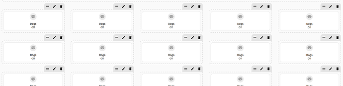

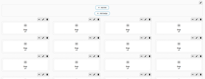

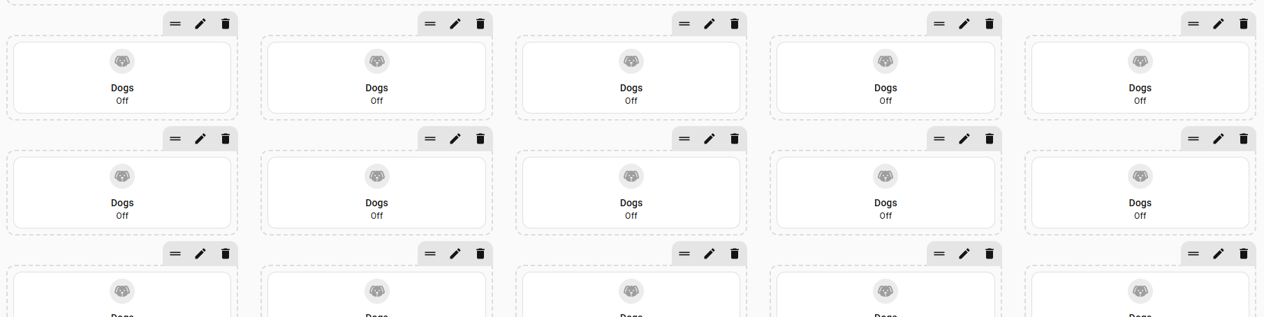

Which yields:

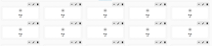

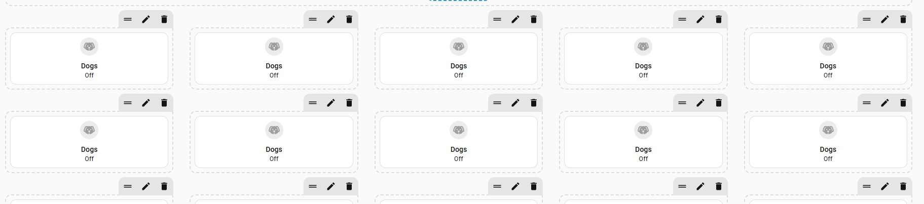

How does one get up to 8 columns depending on device? (Shrinking the included card with card-mod just makes the card smaller in the grid and does not allow more cards). I believe it is not possible to have more than 5, 4 if sidebar is open no matter what settings are applied. Which means the slider in the dashboard of type sections should allow for 1,2,3,4,5 columns … there is no such thing as 6,7,8,9,10.
From documentation:
  1. Under Max number of sections wide, select the maximum number of columns you want to see in the new sections view.
Choosing anything over 5 is worthless.
Proof:
Select 4:
Select 5:
Select 6:
Select 8:
Nothing more than 5 actually works.
Changing the width of the card in the section using card-mod does nothing to change the column widths, it only changes the size of the card in the column.
So, I can only conclude it is impossible to create anything greater then 4/5 columns wide.

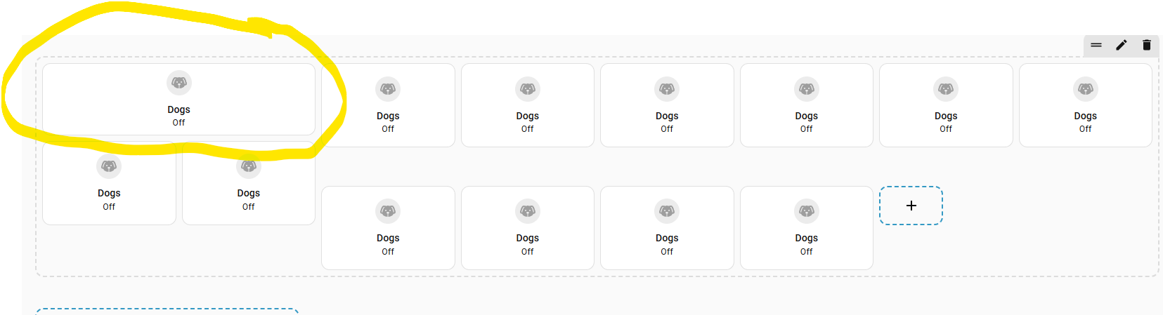

I can get a perfect layout without decluttering, not with it:

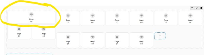

The yellow is the EXACT card as the rest, only created by decluttering … the rest work perfect. The decluttering card is wrong.
removing decluttering (in this case) and auto-entities with decluttering is not really a viable option.
