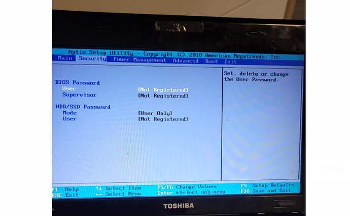

1- UEFI booting- I can’t seem to find this on the laptop
2- Security booting = OFF - I can’t find that in my bios either

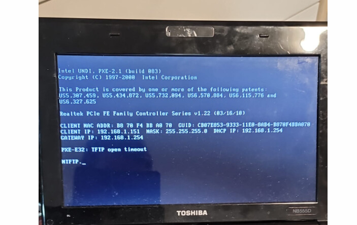

The 3 issue is BE reach to 25% then the entire laptop froze. I did a hard power off (holding the power button until the laptop turn OFF). I unplug the USB, plug in the ethernet cable and power on the laptop.
I tried most of the comments in the comment section of the video. Any help would be greatly appreciated
It doesn’t look like it supports UEFI, so you can’t install Home Assistant OS.
If you’re comfortable with Linux (or want to learn) install Debian (11 - Bullseye) server (no UI) on it, and use the Container install method. You don’t get add-ons, but those are just software running inside a container anyway so you can usually find a Docker alternative.
