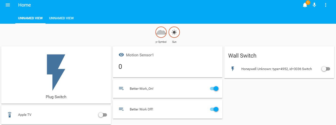

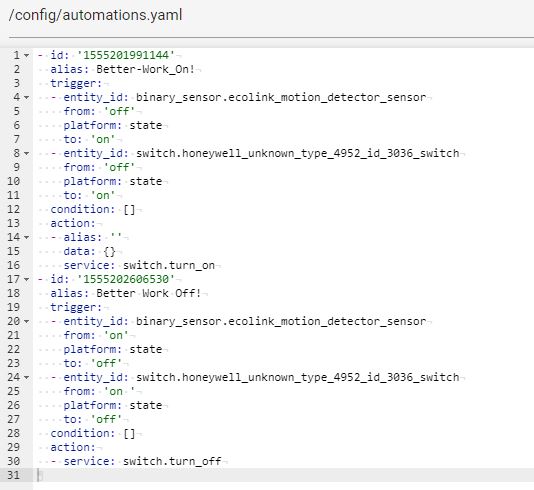

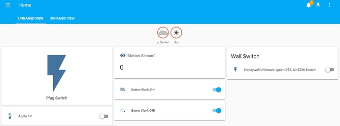

Attached is a snapshot of my overview page and the automation script. I’ve tried to start out simple with just manual control of each switch then put them into an automationAutomation
I think I see what is happening in the first automation. In the action, you are specifying a service but no entity. Here is an example of mine that turns on a particular switch at sunset.

what are the entity_id’s of both switches?
also it’s better if you copy and paste your actual code into the post instead of using a screen shot.
make sure you format it correctly.
This is working now. The motion sensor turns on the honeywell 4952 switch only, then when the motion sensor goes low the switch turns off. I added the switch entity id to the data section just above the
service: switch.turn_on statement.
