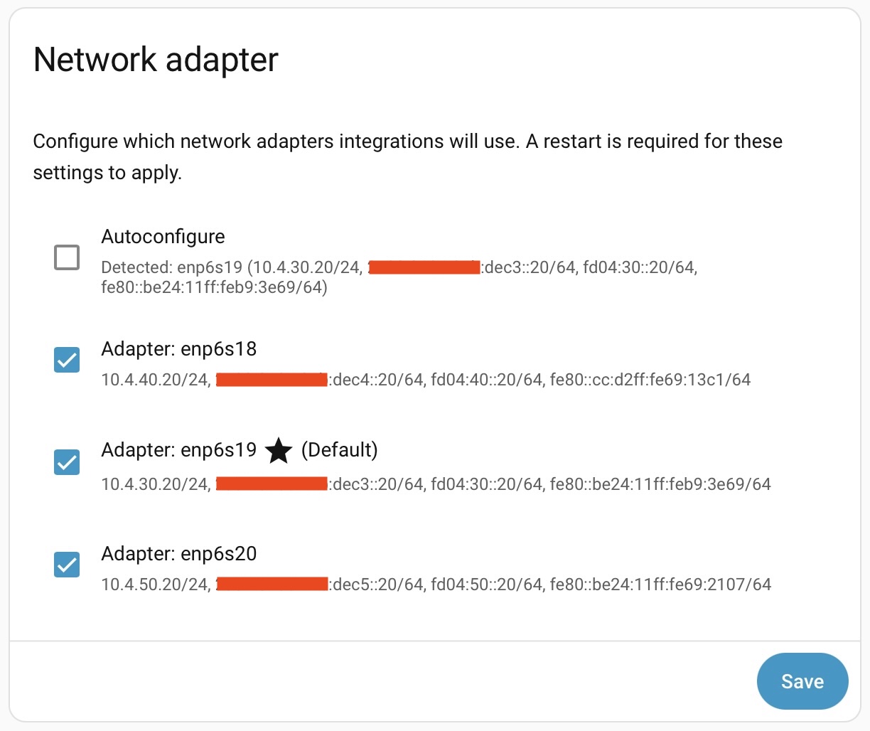

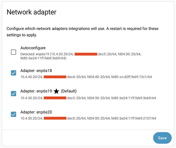

Here is my corresponding config file for the highest priority adapter (default route), combined with a tokenized ipv6 block:
# cat /etc/NetworkManager/system-connections/Supervisor\ enp6s19.nmconnection
[connection]
id=Supervisor enp6s19
uuid=468c1fb7-ba8c-3572-83de-fc45502c34c3
type=ethernet
autoconnect-priority=-999
timestamp=1767942848
[ethernet]
cloned-mac-address=preserve
[match]
path=pci-0000:06:13.0;
[ipv4]
address1=10.4.30.20/24,10.4.30.1
dns=10.4.30.10;
method=manual
route-metric=100
[ipv6]
addr-gen-mode=eui64
method=auto
route-metric=100
token=::20
[proxy]
The result can also be seen on the frontend:
