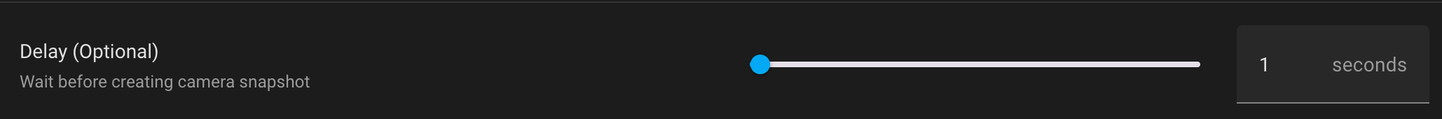

The default delay seems to be set to empty string which might give you an error,did you try to explictly set it lower?
