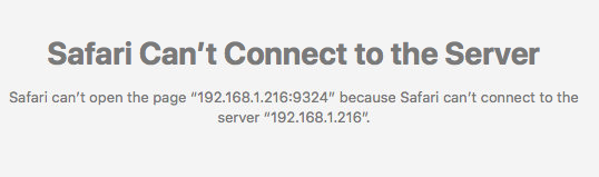

So I ran through all of the steps to set this up.
When I get my token back from Google I paste it into the WebUI and I get things similar to this:
Chrome reacted similarly.
Restarting the container doesn’t seem to fix the issue, it needs to be uninstalled and re-installed to get back to a state where there’s even any WebUI.
These are the latest logs:
