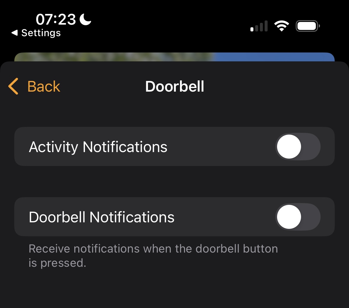

From what I know, you cannot configure custom. notifications in HomeKit. You can enable only built-in ones. For example, HomeKit has support for when a camera detects motion, when a cover is opened or closed, a lock was locked or unlocked, or your alarm was armed or disarmed. For the camera, you need to create a link between your camera and the motion detection entity in the HomeKit bridge configuration.
Here is what you get when you go to your home’s settings in iOS when navigating into a specific person’s settings and a device.
