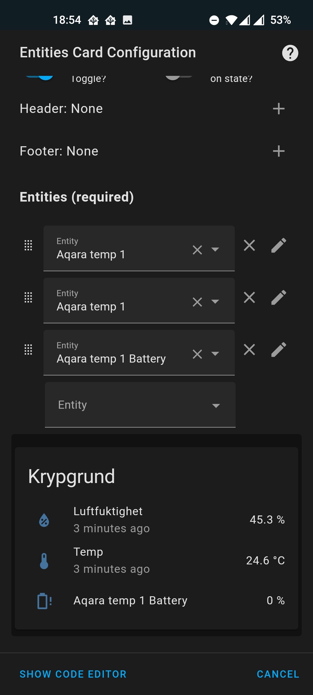

I have conbee II and Aqara temperature and humidity sensor. It works fine except that the battery reporting is not correct.
As a fail safe, I would like to run an automation when the sensors last update is more than x amounts of hours old. This way I could react if there are connection issues or empty battery. How can I do this?
