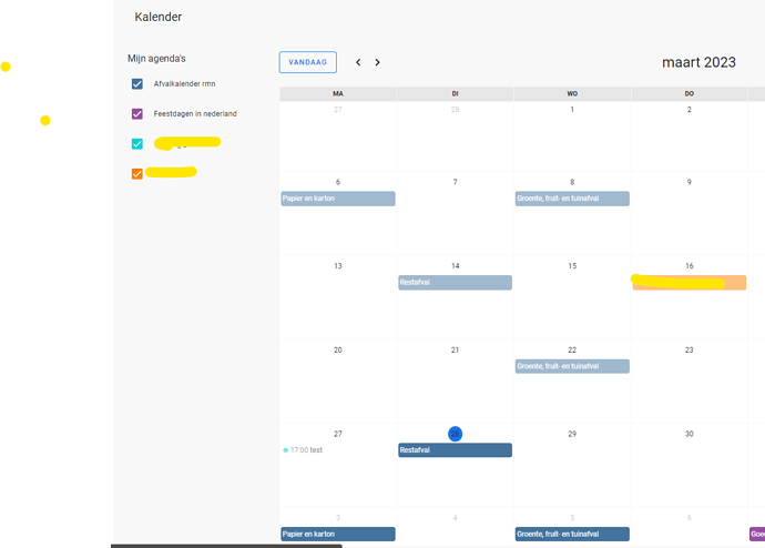

Why this isnt working? The push notification i get has unknown in it instead of summary of the calender event.
Its btw a all day event. I want a trigger when theres a all day event on my phone with the title of it.

But still no message on my phone, when i look into the tracing i see the following:
Error: Error rendering data template: UndefinedError: ‘dict object’ has no attribute ‘calendar_event’
But you’ll have to check your developertool/state & template editor on how exactly your calendar’s attribute states looks like (as I am using another afval sensor)
Ohh now i get a Restafval message.

Its a local added calendar into my google calendar. So i see the calendar in my HA
Ofc it is possible to use your own calendar (just have to figure out how).
But…wouldn’t it be easier to use an existing solution from HACS?
Lol i will take a look into this thanks!
My place was inside the afvalinfo but too bad they closed the api (RMN) for this use. So i need to stick to google calendar again…
