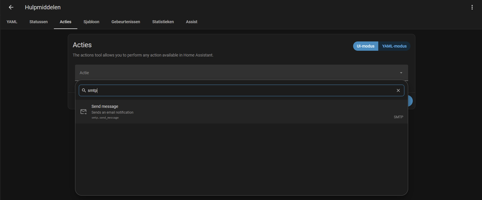

The new way is to use the SMTP send message service. The screenshot below is from the development tool.

smtp.send_message doesn’t appear to be usable in a notify action group:
Invalid config for 'group' from integration 'notify' at notify.yaml, line 8: invalid slug smtp.send_message (try smtp_send_message) for dictionary value 'services->0->action', got 'smtp.send_message'
