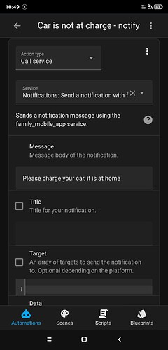

After creating group with multiple devices, it will expose a new service and you will call it.
service: notify.family_mobile_app
  message: Please charge your car, it is at home
Yet it seems not valid:
I am aware of that part. I couldnt figure out the yaml code yet.
