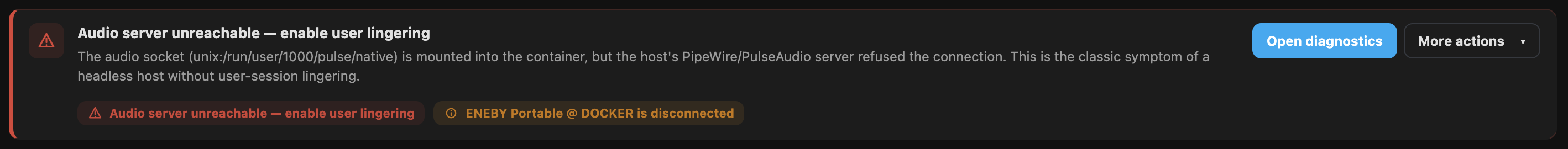

Hi @LongF ! Thanks a lot for trying the bridge and for the detailed report :pray:
rfkill - good catch! We’ve just added rfkill unblock bluetooth to the container startup so this will be handled automatically in the next release. For now your manual workaround is exactly right.
Restart PermissionError - this is a known issue fixed in the 2.54.1 release. The container sends SIGTERM to PID 1 on restart, but some Docker security profiles block that. The fix adds a fallback that handles this gracefully.
One-stream limit on Pi 4 built-in BT - correct, the BCM4345C0 on the Pi 4 supports only one concurrent A2DP stream. USB dongles (any RTL8761B-based, e.g. TP-Link UB500 ~$12) will give you multiple streams - each dongle handles 2–3 speakers reliably. We’ve added a Bluetooth Adapters page to the docs with specific recommendations.
Let us know how it goes with the dongles!

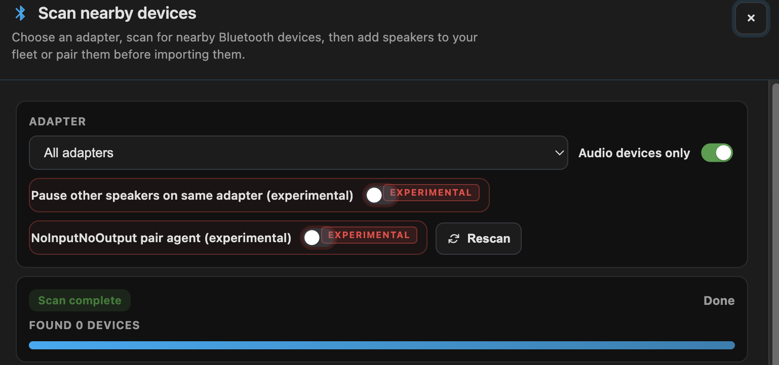

Thank you so much for the guidance!
A little more context - like I said, they came with the house … I have no clue what the exact model is, I know the brand is Homewerks cause that is the name I see when pairing them, but no manual. They are the ceiling vent kind that they sell at Home Depot, so no buttons or markings.
  1. They do emit a specific sound when they are in pairing mode, so that is how I know. Plus, I can see them and pair them to two laptops and two phones (not all at once of course :smiley: ) - so this is how I know they do in fact work and pair ok. I did the whole dance of pairing them, forgetting the device, restarting into pairing mode over and over for a few hours yesterday :slight_smile:
  2. I did this yesterday - bluetoothctl scan bredr - no dice, I even found devices that belong to my neighbors but not the speakers. I did this by selecting the different BT controllers one at a time too, in case that was affecting the discovery (it was - with them selected individually I was seeing a lot more devices, just not the ones I needed)
On my laptop, where I can actually see and pair the speakers, I did that and got the mac address once paired. And at that point I was already drinking on my patio, so they do in fact reach quite far, haha :slight_smile:
      Connected:
          HOMEWERKS(0250):
              Address: 56:58:02:B8:02:50
              Minor Type: Headset
              RSSI: -79
              Services: 0x800018 < AVRCP A2DP ACL >
Then I forgot the device, turned BT off on the laptop, restarted the speakers and tried to directly trust and pair with the rpi like so:
sudo bluetoothctl
select 00:1A:7D:DA:71:03
power on
trust 56:58:02:B8:02:50
pair 56:58:02:B8:02:50
No luck, it was not seeing them :frowning:

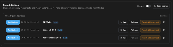

These are the devices - the integrated BT on the rpi 5, Sena UD100-G03 and Feasycom-ancient-something
➜  ~ cat /sys/class/bluetooth/hci0/device/uevent
DEVTYPE=usb_interface
DRIVER=btusb
PRODUCT=a12/1/8891
TYPE=224/1/1
INTERFACE=224/1/1
MODALIAS=usb:v0A12p0001d8891dcE0dsc01dp01icE0isc01ip01in00
➜  ~ cat /sys/class/bluetooth/hci1/device/uevent
DRIVER=hci_uart_bcm
OF_NAME=bluetooth
OF_FULLNAME=/soc@107c000000/serial@7d50c000/bluetooth
OF_COMPATIBLE_0=brcm,bcm43438-bt
OF_COMPATIBLE_N=1
MODALIAS=of:NbluetoothT(null)Cbrcm,bcm43438-bt
➜  ~ cat /sys/class/bluetooth/hci2/device/uevent
DRIVER=btusb
PRODUCT=a12/1/8241
TYPE=224/1/1
INTERFACE=224/1/1
MODALIAS=usb:v0A12p0001d8241dcE0dsc01dp01icE0isc01ip01in00

@mmstano Thanks for the suggestion - unfortunately I keep getting not available
➜  ~ sudo bluetoothctl
[NEW] Media /org/bluez/hci0
        SupportedUUIDs: 0000110a-0000-1000-8000-00805f9b34fb
        SupportedUUIDs: 0000110b-0000-1000-8000-00805f9b34fb
        SupportedUUIDs: 0000FDF0-0000-1000-8000-00805f9b34fb
[NEW] Media /org/bluez/hci1
[NEW] Media /org/bluez/hci2
Agent registered
[CHG] Controller EC:75:0C:A5:87:10 Pairable: yes
[CHG] Controller 2C:CF:67:96:15:68 Pairable: yes
[CHG] Controller 00:1A:7D:DA:71:03 Pairable: yes
hci2 new_settings: powered bondable ssp br/edr le secure-conn
hci1 new_settings: powered bondable ssp br/edr le secure-conn
hci0 new_settings: powered bondable ssp br/edr le secure-conn
AdvertisementMonitor path registered
[bluetoothctl]> select EC:75:0C:A5:87:10
Controller EC:75:0C:A5:87:10 homeassistant [default]
[bluetoothctl]> power on
Changing power on succeeded
[bluetoothctl]> pair 56:58:02:B8:02:50
Device 56:58:02:B8:02:50 not available
[DEL] Device 7D:3A:67:44:C2:90 7D-3A-67-44-C2-90
[DEL] DeviceSet /org/bluez/hci1/dev_7D_3A_67_44_C2_90
[bluetoothctl]> trust 56:58:02:B8:02:50
[DEL] Device A4:C1:38:5B:28:44 A4-C1-38-5B-28-44
[DEL] DeviceSet /org/bluez/hci2/dev_A4_C1_38_5B_28_44
[DEL] Device 74:D4:23:7B:65:B4 74-D4-23-7B-65-B4
[DEL] DeviceSet /org/bluez/hci2/dev_74_D4_23_7B_65_B4
[DEL] DeviceSet /org/bluez/hci1/dev_74_D4_23_7B_65_B4
[bluetoothctl]>

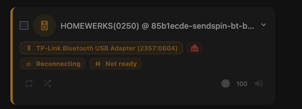

I rebooted everything to be safe, also installed today’s app update, and disabled BT on both my phone and laptop just in case.
Additionally, I fugured I’d hardcode the TP Link in the config and manually add the speaker by MAC address to the bridge - nothing
sendspin_server: auto
sendspin_port: 9000
bridge_name: 85b1ecde-sendspin-bt-bridge
ha_area_name_assist_enabled: true
tz: America/Phoenix
pulse_latency_msec: 600
startup_banner_grace_seconds: 5
recovery_banner_grace_seconds: 15
prefer_sbc_codec: false
bt_check_interval: 10
bt_max_reconnect_fails: 0
log_level: info
ma_api_url: ""
ma_api_token: ""
ma_auto_silent_auth: true
volume_via_ma: true
bluetooth_devices:
  - mac: 56:58:02:B8:02:50
    player_name: HOMEWERKS(0250)
    adapter: hci2
    preferred_format: flac:44100:16:2
bluetooth_adapters:
  - id: hci2
    mac: EC:75:0C:A5:87:10
    name: TP-Link Bluetooth USB Adapter (2357:0604)
At this point, I think it might be time to give up - not meant to be :slight_smile: No idea what else can I do (that does not involve going up into the attic and replacing the stupid speaker) so I am letting this go … But I still do think that sendspin would be a godsend for those kinds of set ups and thank you for your efforts!

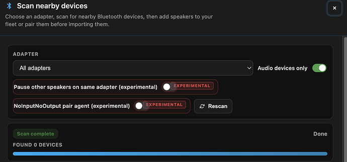

Hi @AdoraBelle, I did some research on your specific situation and I think I found the root cause.
The MAC address is the clue
Your speaker’s MAC 56:58:02:B8:02:50 has the locally administered bit set (first octet 0x56 = 01010110, bit 1 = 1). This means the address was generated by the speaker’s firmware, not assigned by IEEE to a manufacturer.
The Bluetooth spec requires public (IEEE-assigned) BD_ADDR for BR/EDR (Classic). Locally administered / random addresses are only formally supported in BLE. BlueZ follows this strictly - which is likely why it ignores inquiry responses from your speakers entirely. Android, iOS, and Windows stacks are more permissive and accept these non-standard addresses, which is why your phone and laptop can see them just fine.
About your adapters
  • hci0 / hci2 (0a12:0001) - these are CSR8510 clones. The VID:PID 0a12:0001 is the most commonly faked Bluetooth dongle identifier. Linux kernel since 5.8 actively detects and adds workarounds for these clones, often limiting their functionality. These are probably not helping your situation.
  • hci1 (RPi 5 BCM43438) - built-in, limited transmit power for BR/EDR
  • TP-Link UB500 Plus (hci2, 2357:0604, RTL8761B) - this is a proper adapter and the fact that it also can’t discover the speakers confirms the issue is on the speaker side, not the adapter side.
About the speakers
Looking up the FCC filing (SYJHOMEWERKS2), these are ~2014 era speakers with Bluetooth 2.1+EDR, only 2 mW output power. There are known compatibility issues even with newer iPhones (iPhone 12+). The cheap BT module inside has a non-standard implementation that happens to work with consumer device stacks but not with Linux BlueZ.
One last thing to try
Since you already have the MAC address from your laptop, you could try bypassing BlueZ’s discovery entirely and forcing a direct baseband connection (a “page” request):
# SSH into your HA / Pi
# Put speaker into pairing mode first!
# 1. Start HCI-level monitoring (in background)
sudo btmon &
# 2. Attempt direct connection by MAC, bypassing inquiry
sudo hcitool -i hci2 cc 56:58:02:B8:02:50
# 3. If that succeeds, try pairing via bluetoothctl
bluetoothctl pair 56:58:02:B8:02:50
hcitool cc sends a page request directly to the MAC address — no inquiry/discovery needed. If the speaker is in “connectable” mode (page scan enabled), this might work even though bluetoothctl scan can’t find it.
Also worth checking: does HA’s built-in Bluetooth integration have its hands on any of the adapters? If it’s setting discovery filters, that could interfere. Try temporarily disabling the HA
Bluetooth integration in Settings → Devices & Services.
Honest assessment
If hcitool cc doesn’t work either, this is most likely an unfixable incompatibility between these specific speakers and the Linux Bluetooth stack. The locally administered MAC + vintage 2014 firmware is a combination that BlueZ simply wasn’t designed to handle in BR/EDR mode. No adapter change will help because the issue is at the protocol level.
The speakers will continue to work perfectly with phones and laptops that use more forgiving Bluetooth stacks. For the bridge, you’d need speakers with standard-compliant Bluetooth addressing - which is pretty much any mainstream Bluetooth speaker from the last decade.
Sorry I don’t have better news, but I hope the hcitool cc workaround is worth a shot! :crossed_fingers:

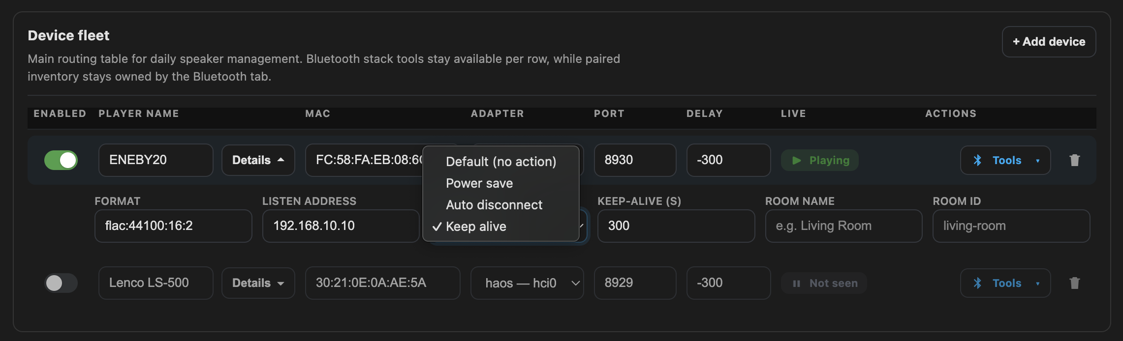

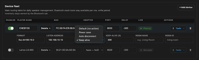

  • default (speaker’s own timer),
  • power save (suspend PA sink → release A2DP → speaker sleeps, BT stays connected → instant resume),
  • auto disconnect (full BT disconnect after timeout),
  • keep alive (2 Hz infrasound bursts at −50 dB — below human hearing but keeps A2DP active on speakers that ignore digital silence).

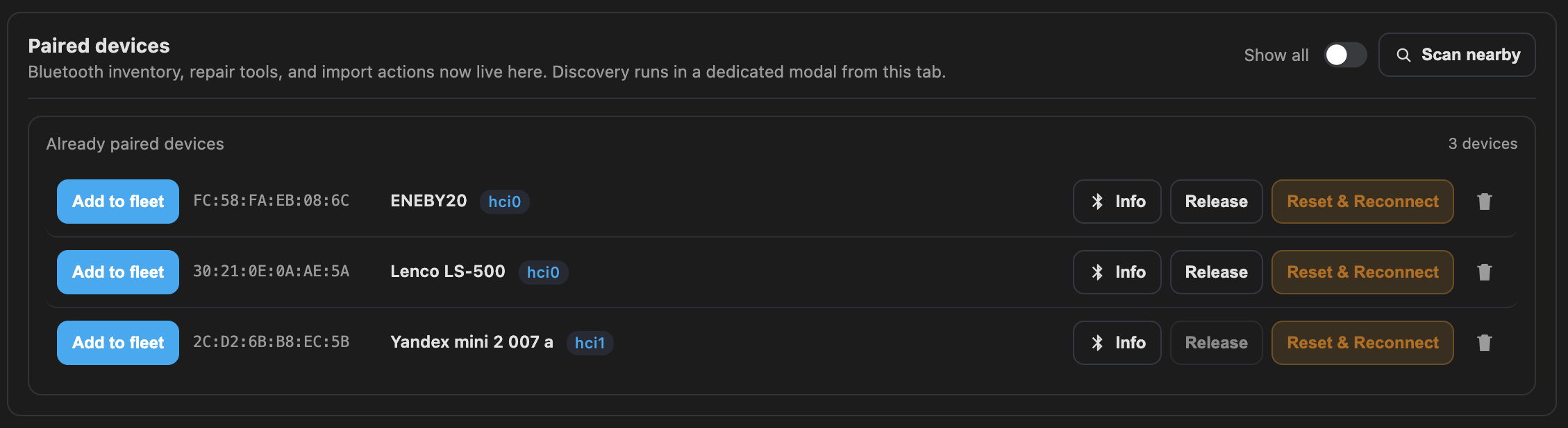

I can’t get this to connect to multiple speakers at once … either it pairs to the one speaker or the other one. But never to both at the same time. Using a ASUS BT500
Thanks for the report! Two speakers on a single adapter (incl. ASUS BT500) should work — that’s the default topology for most users.
Easiest way to get this fixed: please open the web UI → Diagnostics panel → click the Report button. It creates a GitHub issue pre-filled with your config, BlueZ/PulseAudio state, and per-device last_error — everything needed to pinpoint the cause in one go.
If you’re on anything earlier than v2.60.1, also try updating first — that release shipped a fix for a stale-agent / legacy-pair bug that could exactly match your symptom (one pair works, the next
silently fails with ConnectionAttemptFailed).

Fix: Sendspin Bluetooth Bridge on Raspberry Pi - Audio Sink Not Detected
Problem
The container runs as root by default, but the PulseAudio/PipeWire socket at /run/user/1000/pulse/native has 700 permissions (owner-only access). Root cannot access a socket owned by user 1000, causing Connection refused when pactl runs inside the container.
Symptoms
  • Web UI shows “No Bluetooth controller detected” (false negative)
  • Or Bluetooth connects but pactl list sinks short returns Connection refused
  • Audio sink never appears in Music Assistant
Solution
Add user: "1000:1000" to the docker-compose.yml to run the container as the same user that owns the PulseAudio socket.
Modified docker-compose.yml:
services:
sendspin-client:
image: Package sendspin-bt-bridge · GitHub
container_name: sendspin-client
restart: unless-stopped
user: “1000:1000” # ← ADD THIS LINE
network_mode: host
# … rest of config unchanged …
Apply the fix
cd ~/sendspin-bt-bridge
docker compose down
docker compose up -d
docker exec sendspin-client bluetoothctl connect
Verify
docker exec sendspin-client pactl list sinks short
Should show: bluez_output.xx_xx_xx_xx_xx_xx.1
~/sendspin-bt-bridge $ docker exec sendspin-client pactl list sinks short
90 bluez_output.32_CD_CA_88_A6_0F.1 PipeWire s16le 2ch 48000Hz SUSPENDED
101 sendspin_fallback PipeWire float32le 2ch 44100Hz SUSPENDED
harry1@rooftop-bridge:~/sendspin-bt-bridge $
