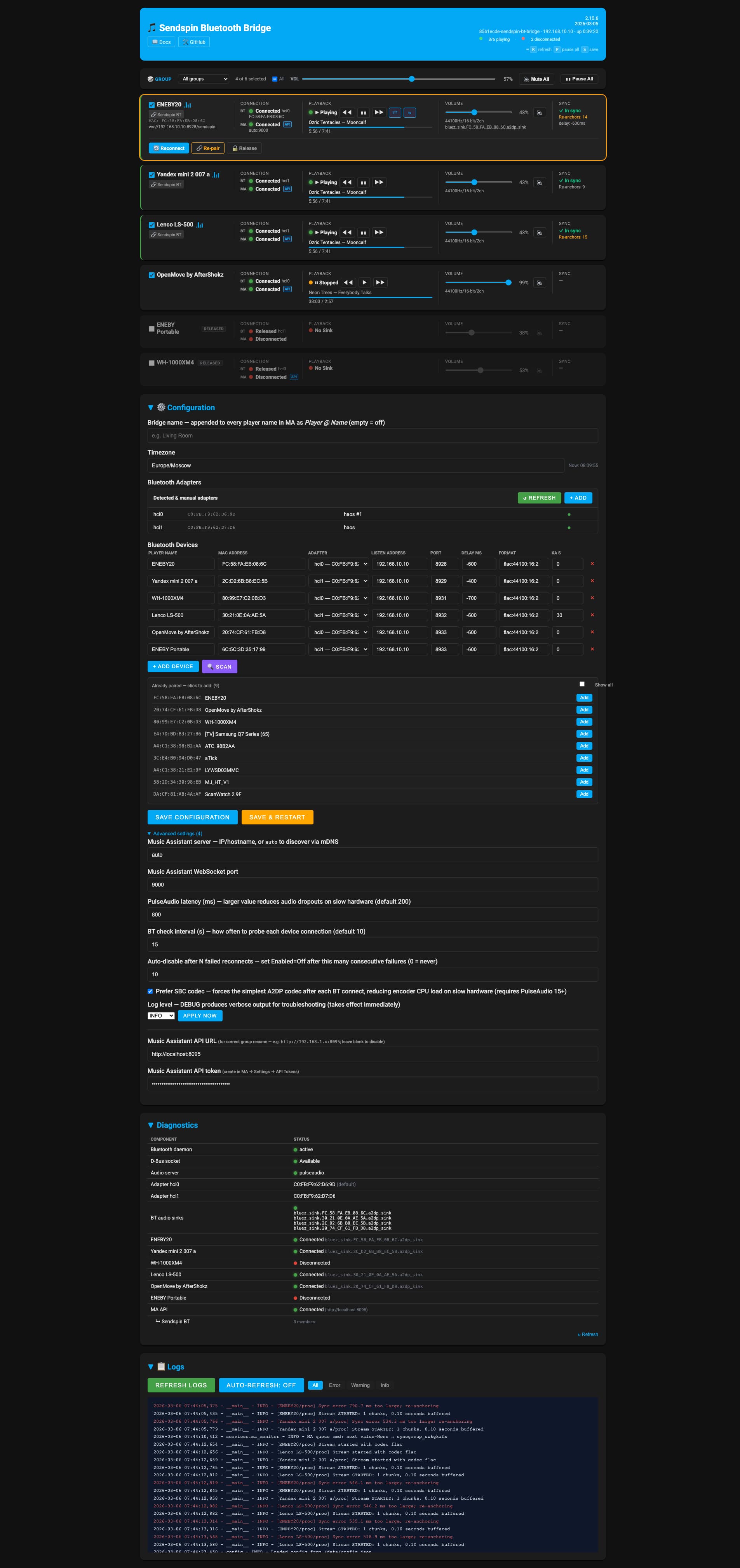

Hey everyone! Sharing a companion project built on top of the Sendspin protocol.
What it does: Each Bluetooth speaker appears as a regular player in Music Assistant — play music, control volume, group for multiroom, all from the MA UI or a dedicated web dashboard.
Key features:
• Multi-device — bridge multiple BT speakers simultaneously, each as its own MA player
• Multiroom sync — group speakers across bridge instances with MA sync groups
• 4 deployment options — HA addon, Docker Compose, Proxmox LXC, OpenWrt LXC
• Web dashboard — real-time SSE updates, dark/light theme, transport controls
• Auto-reconnect with D-Bus disconnect detection
• Per-device latency compensation (static_delay_ms)
• Lazy startup — daemon starts only when BT connects (no phantom players)
Tested with 5 speakers across 3 bridge instances (x86_64 + ARMv7), CSR8510 USB adapters:
