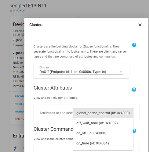

I’m wondering if anyone has any pointers on where I can find out all the parameters for a ZigBee bulb like the Sengled E13-N11. My ZigBee integration picked it up fine, and I see motion alarms, can turn the bulb on/off and can set brightness. But I’d like to tweak it’s settings for motion sensitivity, how long the light stays on, etc. My understanding is that these will be in the Cluster Attributes on the device – and for some of my other ZigBee or Z-Wave devices the products came with charts indicating what all the parameters were, and their valid value ranges. This product didn’t include any charts, and my Google-Fu is failing me.

I still haven’t found any documentation, and playing around with some of the clusters I still haven’t been able to make any meaningful guesses as to the values needed to turn off Motion detection, or adjust how long it stays on/off – perhaps if someone has a Sengled Hub they might be able to somehow snoop the values needed – since their hub + app seems to support the settings:
