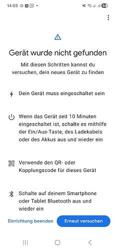

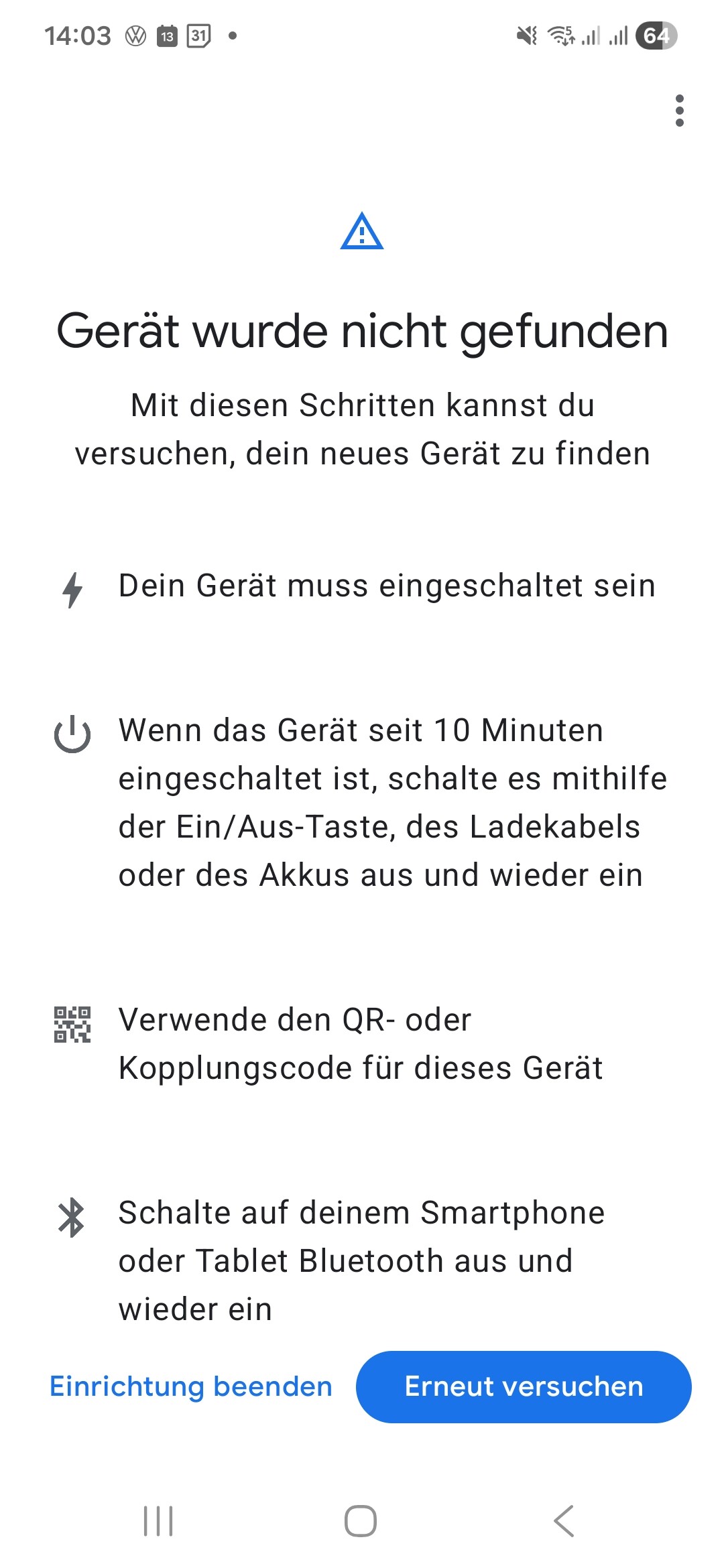

. Unfortunately I can’t get the device registered. Either I get a timeout or an error that a Thread Boarder Router is missing (which is not the case and I tried it just in one meter distance of the TBR). I have several Matter over Thread devices already which are working without an Issue. Are smoke alarms maybe not supported by Home Assistant Matter integration? Tried with two devices.
Is there any way I can get some details logs on what went wrong. Eg.: Does it fail on in the App already to connect to the device or for the device to connect to the Thread network…

I got it now finally working. I had to sync the Thread credentials again in the Android Companion App (under Settings → Troubleshooting). Same issue was on my wife’s Android phone. The App should be improved to suggest this fix instead of the wrong error that a Thread Border Router is required.
