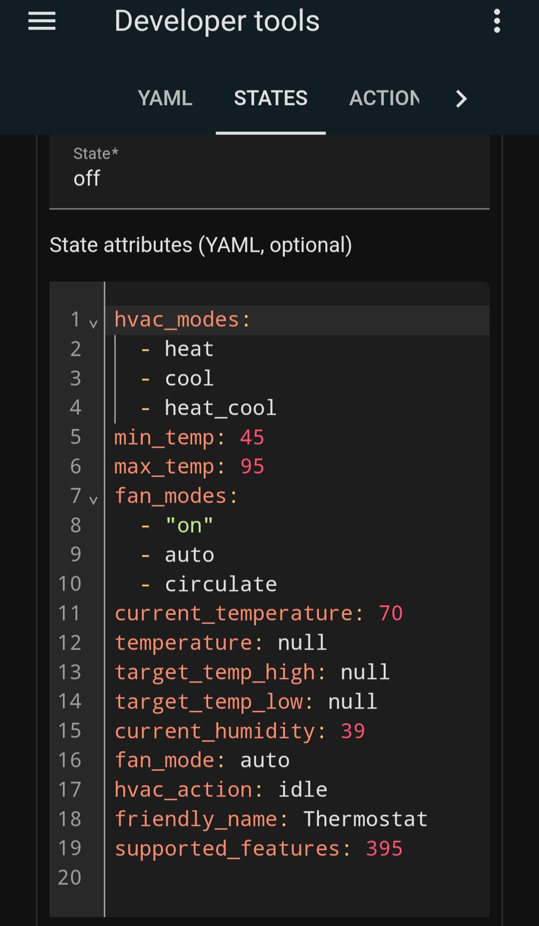

After updating to 2025.3.4 and getting the prompt to authenticate my SmartThings integration again with that newly updated process, I realized I don’t have some modes on my thermostat. Honestly, I don’t know what options were all there before because I generally just use Google Home or Alexa to control it from my Home Assistant setup. Google Home and Alexa are not setup for SmartThings nor Sensi directly. Only realized something was missing when Alexa couldn’t turn the thermostat OFF. Found the mode is missing:
Then found that the mode is in place within SmartThings, along with Emergency Heat which I didn’t realize was also gone.
