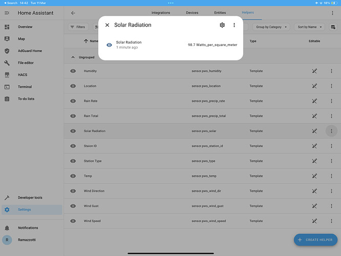

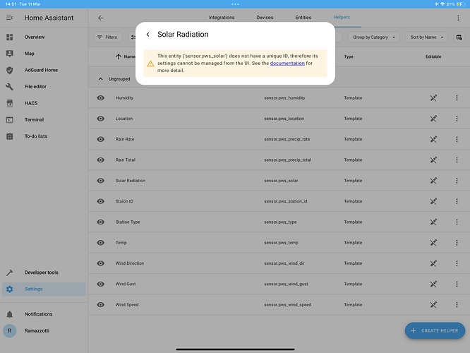

I have installed this integration and it seems to be working fine. However some sensors are not being showed and are actually not useful. (see picture) Can anyone help me resolve this? Thank you.
