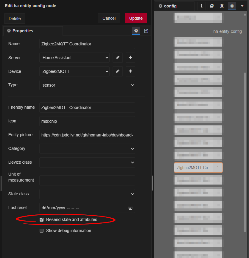

where I can I find this setting? I only see “Resend state and attributes” but that doesn’t work.
That’s the one I used you mentioned “Resend states and attributes”
What other settings you’re having? Do you have as state class total increasing?
And also a device configured?

I ran into this issue recently with NodeRed sensors based on MQTT. Whenever HA would be restarted, the NodeRed sensors would go unknown. I couldn’t easily use an inject node as the sensors were based on MQTT, which only triggers with a new MQTT message and not when HA restarts.
I found that setting the sensor to “resend states and attributes” in the HA sensor configuration in NodeRed resolved it.
