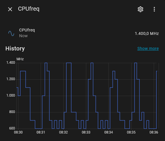

Hi, for anyone trying to achieve this, here’s what worked for me:
(add it to configuration.yaml)
command_line:
  - sensor:
      command: 'cat /sys/devices/system/cpu/cpu0/cpufreq/cpuinfo_cur_freq'
      unit_of_measurement: "MHz"
      value_template: '{{ value | multiply(0.001) }}'
      scan_interval: 1  # (In seconds)
      state_class: MEASUREMENT
      device_class: FREQUENCY
Here’s the result :
