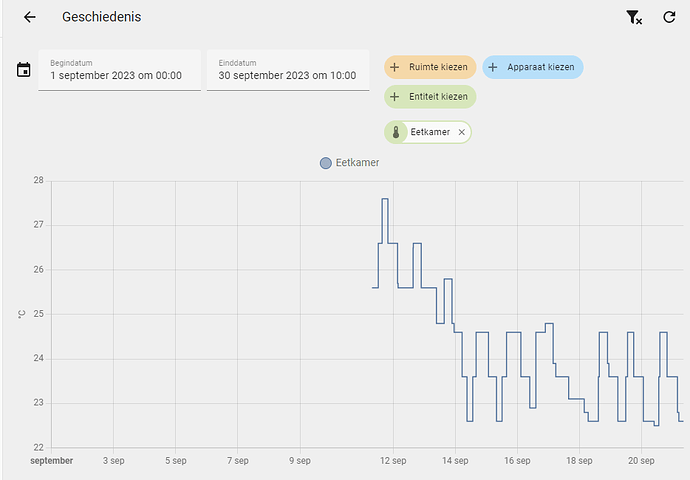

Not sure which update got rid of the temperature history data, but no matter what timeframe i set, only see 9 days back in the history of my temperature sensor.
Is there some secret setting now to get back all history data?
Couple of month ago i could see all history data (at least 6 month) of my temperature sensor.
Thanks for any hint.

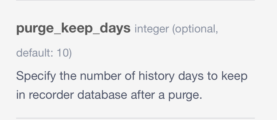

The default recorder purge keep days option is 10 days. Always has been. So unless you deliberately changed it you should only see 10 days of state history.
Perhaps you are thinking of a statistics graph card. That graphs long term statistics which is kept forever (but at a lower resolution).
Maybe a screen recording can bring in some light. I checked the history data a couple of times / month in the past. “Always”, the same way like you see in the screen capture. With the latest update applied, i can no longer see the history data, that was “always” showing up there and is now gone.
So, how can i bring back the history data (more than 10 days) for the temp. sensors?
Screen Capture:
Screen Recording 2023-03-12 at 06.07.37
You never had more than 10 days of history unless you changed the default recorder settings. Did you do that?
https://www.home-assistant.io/integrations/recorder/#purge_keep_days

The recorder database purges state and event history data after the purge_keep_days setting. This is 10 days by default.
Long Term Statistics data (not visible in the history panel) is kept forever.
