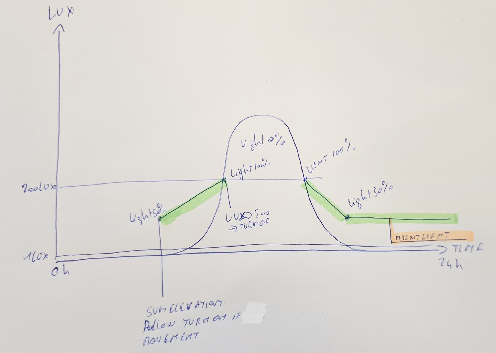

I’m really struggling to use this blueprint, for basic stuffs it’s ok, but for my main rooms, I want the lights to behave like this:
  • in the morning, it’s dark outside, I want my light to be at 50% to feel comfy
  • in the morning when lux rises, I want the lights to follow to 100%
  • in the morning, when lux is more than 200 turn off if no movement
  • in the afternoon, when lux is less than 200 turn on with movement
  • in the evening, do not go below 50%
I tried with 8 - Sun Elevation Lighting - Colour Temp + Lux Controlled Brightness and
9 - Sun Elevation Lighting - Colour Temp + Lux Controlled Brightness Inverted but it’s not following that logic.
I also adjust colour temp, and nightlights (with a Boolean sensor) and that’s working ok
Here is the config.
Any help would be welcome :slight_smile:
