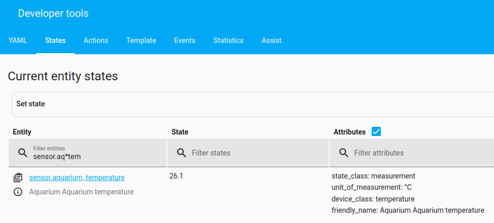

Show us a screenshot of the Developer Tools / States page that shows the feels_like sensors. Like this, but for your entities:
