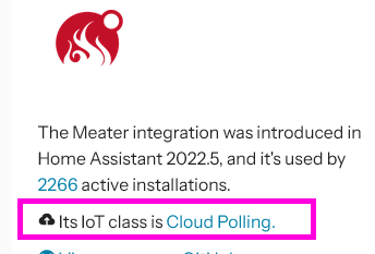

Then you need something that works locally. Meater is a cloud application:
Polling a cloud server every 5 seconds is a sure fire way of getting Home Assistant banned for everyone. Do not do it.
