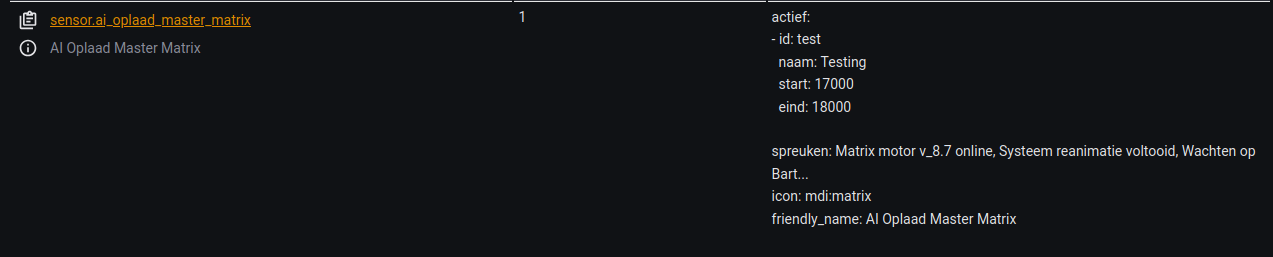

When I try the config I'm getting an error related to the spreuken attribute... it doesn't seem to like the YAML list syntax. If I change it to a list in a Jinja template it works... :man_shrugging:
I've changed my post above to use what is working on my instance:
Thank you for your response. Could you please provide me with the full code you tested?
