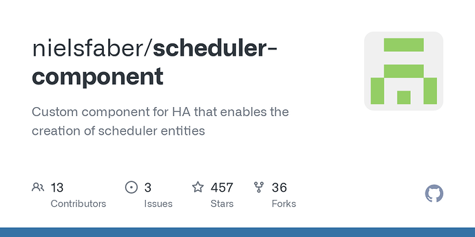

This is another approach that might be useful. Found in HACS. You could set a weekly scheduled event to change the value of an input_select.
