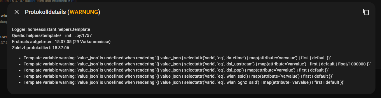

Hey DFS,
I tried to use all oh this to get the entitys to work, But I’m getting several errors at once.
Here all Images:
