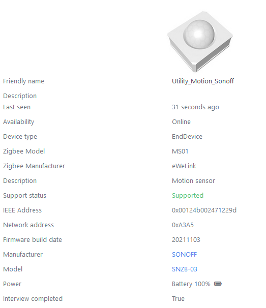

Coordinator: Sonoff Zigbee 3 USB dongle plus V2
Sensor: Sonoff SNZB-03 (I have same issue with OSRAM motion sensor also)
Both sensor are joined to the coordinator directly.
The sensor show in Z2MQTT and show updated status when motion is detected.
The sensor show a status of clear in HA but don’t detect any changes.
I have permit join checked. (I saw another post showing that as a fix).
you can see the last seen changed 31 seconds ago when I triggered it.
you can see the HA value didn’t change to detected 31 seconds ago when it should have been triggered.
