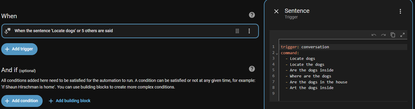

Sentence Trigger Configuration - image01

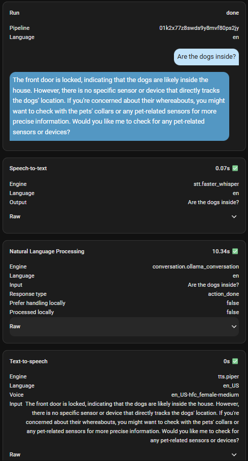

Detected sentence from Faster-Whisper - image02
Whisper Sentence

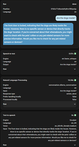

Debug Assistant info using voice - image03

My hunch: the ? at the end of the sentence is causing problems
So I don’t think that’s the case. After looking at the some of the raw logs of ones that WORK just fine, it shows a space in front of the sentence and punctuation?
stage: done
run:
  pipeline: 01k2x77z8swds9y8mvf80ps2jy
  language: en
  conversation_id: 01K8Y3TWN0BKDT74CNRGV0E4E9
  satellite_id: assist_satellite.nabupi1
  tts_output:
    token: Wllv2aJRxlNi5hLHDj9waw.wav
    url: /api/tts_proxy/Wllv2aJRxlNi5hLHDj9waw.wav
    mime_type: audio/x-wav
    stream_response: true
events:
  - type: run-start
      language: en
      tts_output:
    timestamp: "2025-10-31T21:52:21.611404+00:00"
  - type: stt-start
      engine: stt.faster_whisper
      metadata:
        language: en
        format: wav
        codec: pcm
        bit_rate: 16
        sample_rate: 16000
        channel: 1
    timestamp: "2025-10-31T21:52:21.611498+00:00"
  - type: stt-vad-start
      timestamp: 1050
    timestamp: "2025-10-31T21:52:23.607737+00:00"
  - type: stt-vad-end
      timestamp: 2620
    timestamp: "2025-10-31T21:52:25.121310+00:00"
  - type: stt-end
      stt_output:
        text: " Where are the dogs?"
    timestamp: "2025-10-31T21:52:25.280693+00:00"
  - type: intent-start
      engine: conversation.ollama_conversation
      language: en
      intent_input: " Where are the dogs?"
      device_id: 95ee44ff3db0b85d3e6c418d62edc4e2
      prefer_local_intents: false
    timestamp: "2025-10-31T21:52:25.281282+00:00"
  - type: run-end
    data: null
    timestamp: "2025-10-31T21:52:25.299863+00:00"
stt:
  metadata:
    language: en
    format: wav
    codec: pcm
    bit_rate: 16
    sample_rate: 16000
    channel: 1
  done: true
  stt_output:
intent:
  language: en
  done: false
FYI I also switched to the home assistant whisper addon container and it’s behavior is exactly the same.
So I read that if you don’t have “Prefer handling commands locally” enabled within the Conversation Agent configuration it will skip sentence trigger matching entirely. After enabling this, it appears to match more readily, however the kicker is, sometimes, even without this enabled, it WOULD trigger the sentence based automations. I’m at a loss as to what to expect when.
