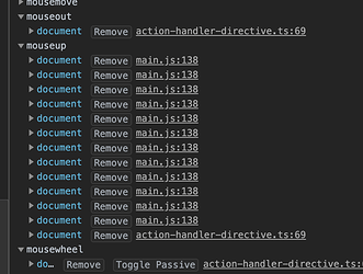

Unused dom elements which doesn’t get cleanup. Look at the DOM Nodes and Event Listenner counts
And after a few clicks…
Redundant event listenners which werern’t removedstrong text during component life cycle
This is an example of using events without removing it when component unmounted
