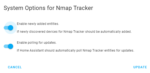

My use case for this is in detecting new entities (NMAP device_trackers) on my network
I believe that the addition of a new device tracker can be detected in an automation with the following trigger
  trigger:
    platform: event
    event_type: entity_registry_updated
    event_data:
      action: create
Home assistant appears to create the device_tracker entity, but creates it as “disabled by integration” in spite of me having explicitly stated that I want to “Enable newly added entities.” (perhaps this is just because the UI needs a language update)
Because the entity is not enabled upon discovery, it seems to not have its attributes in the state machine when one attempts to use a template to report on the attributes of the new entity
{{state_attr(trigger.event.data.entity_id,'friendly_name')}}
Having the ability to enable the entity via a service would allow me to
  1. enable the entity
  2. Wait the prerequisite of 30 seconds for the entity to become available in the state machine
  3. Query the state machine for the device tracker attributes of interest (Source, MAC, IP etc.)
  4. Allow me to construct a human digestible report of what just got added
